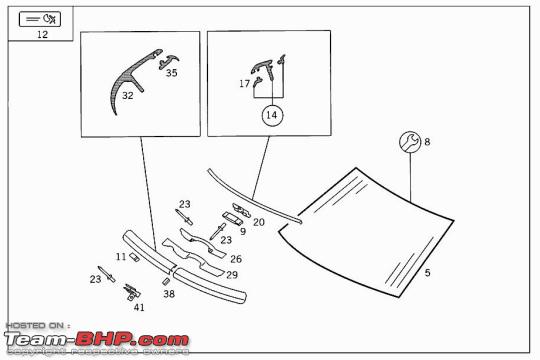

Part Numbers
32: A 124 671 14 30
35: A 001 987 24 60
Generally in most of the replaced windscreen W124 i have seen 26, 29 is missing which leads to the outer seal near the wiper 32 not fitting flush
Refer to image below

Originally Posted by tharakan9 View Post
That will do on the top but what to do about the wiper cowl?
It'll stay in place just as is, a lot of people get it stuck down, but it can be a problem if you ever need to service the AC motor, as the wiper motor assembly has to come out first.
It's a sort of clip system that apparently breaks when the windscreen is removed. I'm not entirely sure. It hasn't been stuck in my E220 and it is just fine. Doesn't flap or move about at all.

Part number 26-29 is basically rivetted at the bottom of the windscreen; on this a rubber gasket 35 is stuck; this is what goes missing resulting in 32 not air tight at the base of the windscreen and wiper motor; this leads to water into the area behind the firewall
Ask me how i know??
My car has this; At the moment i have taped it down for monsoon; will source these parts and fix them for good
Ask me how i know??
Can you please post a photo of your car's windshield area for better understanding?

I dont have my car nearby; however the below photo should help
When this strip is not there; which typically goes missing in new windscreen install; the rubber weatherstrip stay open from the windscreen end and lets water in...
Thank you so much. The photo really helps a lot.

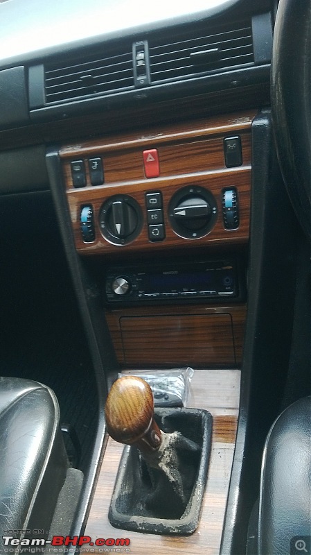

Update
I got new blank Keys from the dealer and had them cut using the original key.
I also got my Owners Service Manual yesterday.So if anyone needs any text or picture help please let me know. My manual is for petrol models only.
I was also wondering that is my FE ok. I get around 7-7.5 km/l with full a/c and in city traffic with speed of around 50-60. And also my fuel needle moves a little while driving and I feel that when I park my car the needle is higher but when i start the car again after sometime it shows a little less reading.
Also got a Kenwood basic stereo fitted.

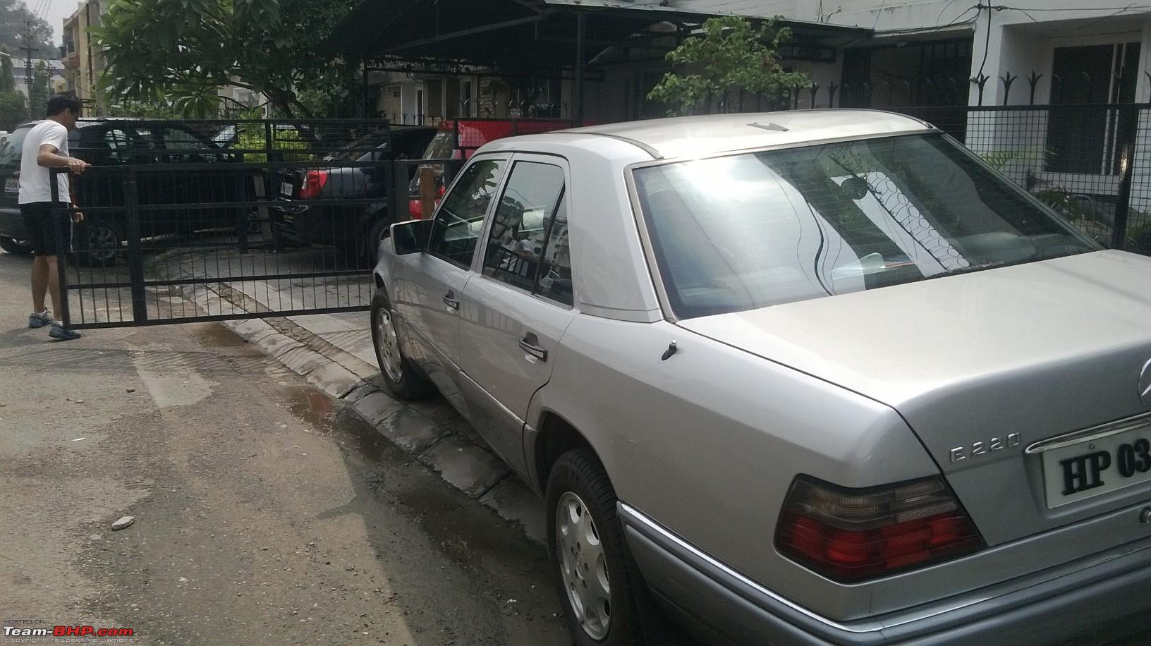

Clicked a few pictures of betz. Will click better pictures on Sunday.
