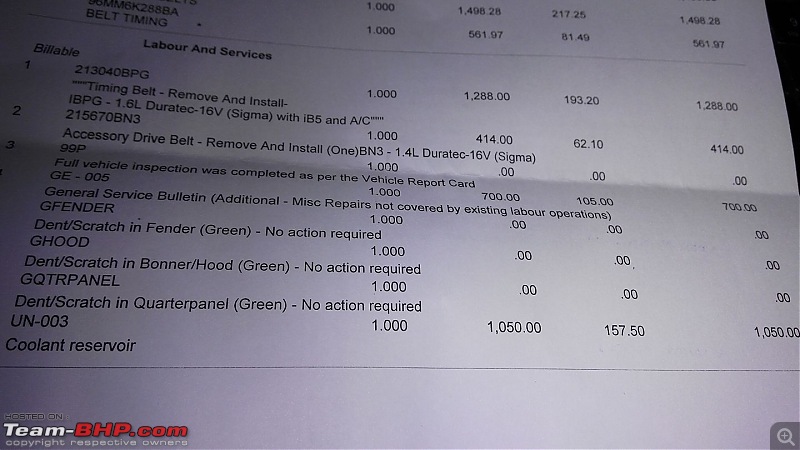

Excerpts are below:
Is it time to change the Timing Belt?-17015805_10154326700456596_2699848495022904734_o.jpg
Is it time to change the Timing Belt?-17038802_10154326703021596_3281862454744608255_o.jpg
The only piece of work that seems to be a bit high is the labor cost charged under the head 'Coolant Reservoir', which amounted to Rs 1050. When I asked the S.A. he said it involves removal, inspection and re-fitting of water pump, topping up coolant and checking the cooling system. I'm not sure if those were a rip off, but as I didn't have the technical knowledge, I did not contest that.

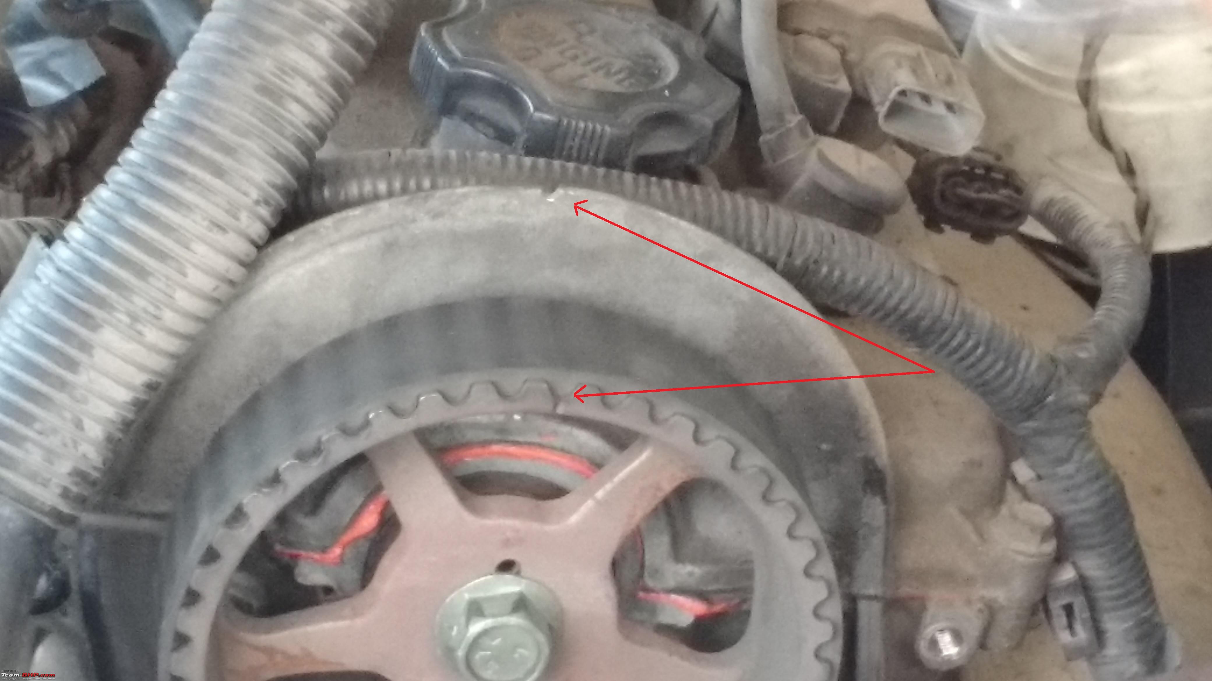

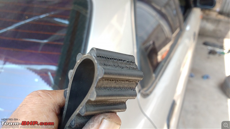

Changed the timing belt of my Baleno - 2004 model, today.
ODO Reading - 1,21,000 kms
Timing Belt - 1614/-
Tensioner - 616/-
Labour - 1200/-
Old Belt. Though it did not seem like it will break soon, it had symptoms of wear and tear. I feel I changed it at the right time.
I think with those sort of wear and tear signs it could have snapped at any moment!
Well done job. Looks like on this car/engine it’s fairly straight forward to get at the belt. Which is great! On some cars it will take many hours of spannering just to get at the belt.
It was not quite easy though. The mechanic had to spend some good 2 hours in getting to it. Had to remove the air filter box, hoses, power steering oil tank, a part of power steering assembly, two drive pulleys, belts, right side wheel, etc. Needed quite lot of different spanners and tools to pull out all of these.
