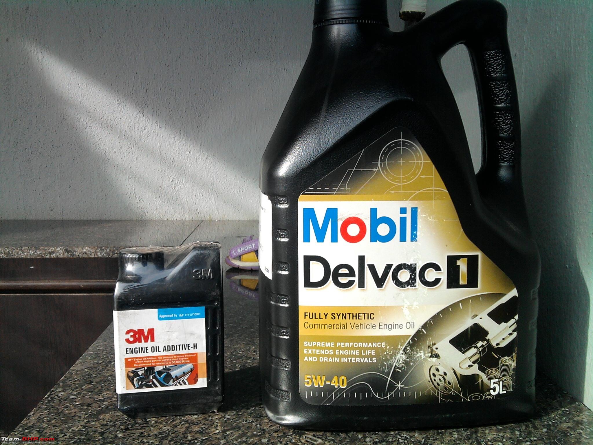

Finally put the fully synthetic oil into my i20 CRDI, car had done around 22,172 kms.
So performance wise, Mobil Delvac MX > Shell Helix HX6.
Attachment 575365
What do you reckon are the chances of the 3M additive making the difference than just the synthetic oil ?

I cannot confirm that 100%, but since I have used full synth oils in bike, I know that synth's do make the engine a lot smoother when compared to mineral.
Since the oil change I haven't had a chance to drive the car much, a couple of days back did a 50 kms drive on the ring road and got a chance to floor the throttle, boy o boy, what a difference it has made, it just revvs so smoothly, the car picks revvs very very quickly and it is smooth, even while revving, I am loving it. I expect the FE to improve too.
Finally is it worth the price? I will reserve my judgement on this, but to be frank the oil is costly. So if you the moolah, I would suggest you to try it at least once. All I can say is that the oil is 100 times better than the Shell Helix HX6 that I had used previously.
