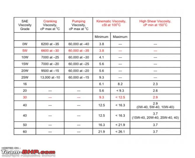

Originally Posted by hrishi_dypim View Post
For example, if there is a very small gap between two metal parts of the engine then thick 0W will work better than the 5W or 10W at cold start. similarly, if the gap is wider 10W or 15 W will work better than 0 or 5 W.
Watch this video for full clarity.
https://Youtu.be/A924OcVU7fs?si=bMGHGzXDK6jYg4sZ
Half knowledge is sometimes more dangerous than no knowledge.
The good part is, that this video recommends to follow manufacturer recommended grade.
There are a few things which the video creator is unaware about.
1. Cranking viscosity.
2. Temperature at which the cranking viscosity is measured.
3. Kinematic viscosity.
The attached image will provide a lot of information that is needed.
Cranking viscosity of 10w is not double of 5w. Moreover, they are measured at different temperatures and cannot be compared.
Additional thought: If I own a R15, normally I will put 15w50 in it, but when I go for racing on a track, I will put 15w60 grade. Racing grades are thicker than normal grades, why? The answer to this question will help one understand what needs to be known.
While racing, will the gap shown in the video become different? Racing oils are thicker, even when they increase the drag, for an occasion where every second counts.
Now, there could be a debate that a synthetic oil of 15w50 vs a mineral oil of 15w60 will perform same even during racing. Yes, it is true, but we are not discussing oil quality here. Just viscosities. More information in the attached link.
https://www.valvolineglobal.com/en-k...ng%20a%20race.

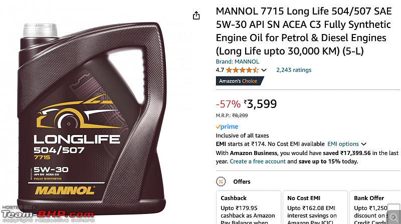

Stumbled upon this thread while I was researching for a good 5w30 engine oil for my Nexon diesel.
Has anyone used Mannol (available on amazon) for their diesel engines?
The reviews are really good and I was wondering if this can be used in Nexon.
Any advice or recommendations?
Thanks in advance.
