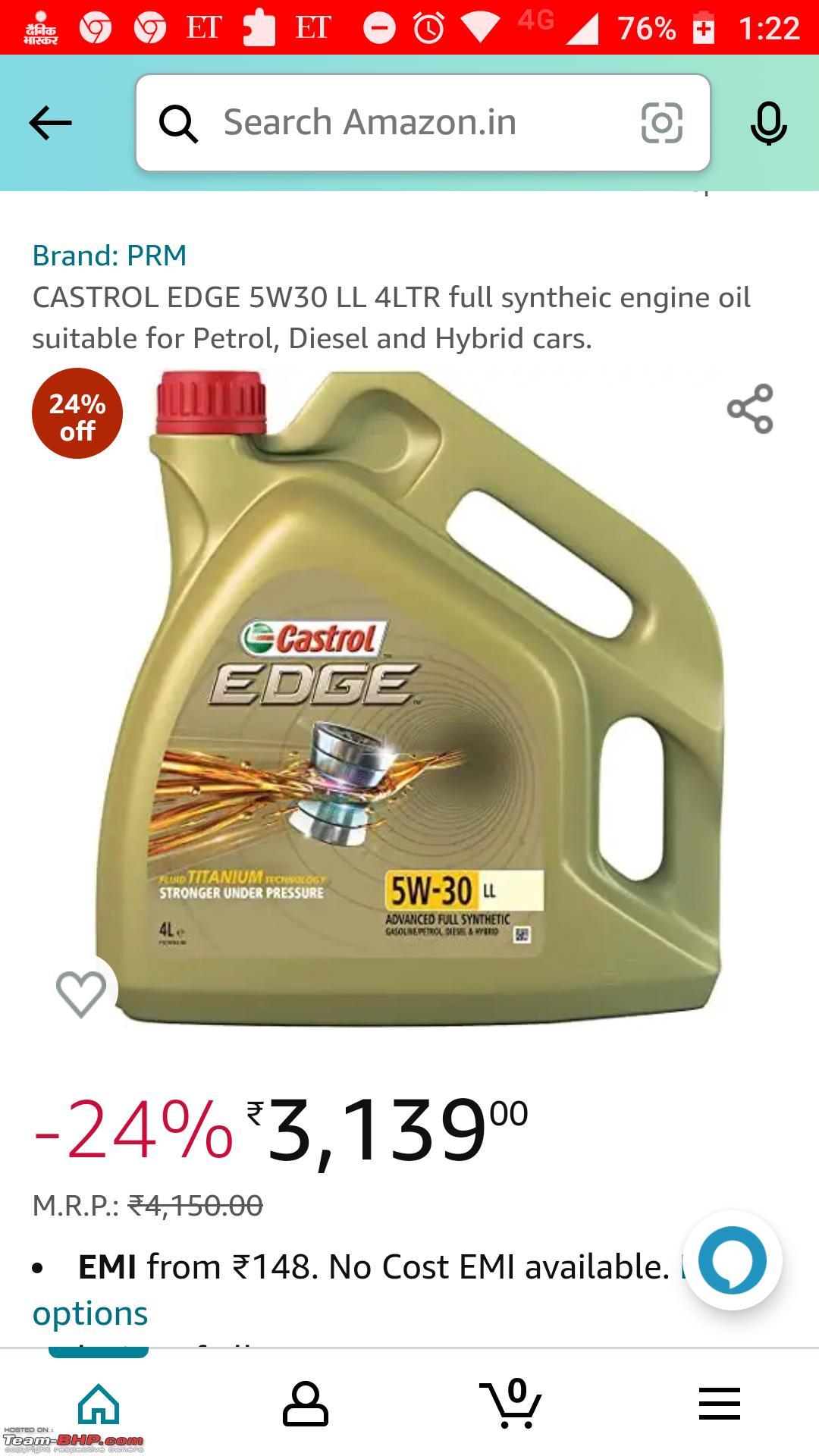

Thanks sir for your kind advice , would definitely try the same at the next service probably within 6 months . Hope you are talking about this product (image attached) .
Yes this is the one.
