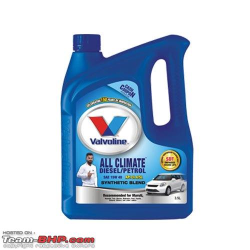

Guess repeating what has been already asked / discussed 'n' number of times. However, this query adds a finer touch
Getting 15w40 oil 3 litre for my petrol car is becoming a hassle. Either the correct grade for a petrol car is not available, or it is available in 3.5 / 4 litre packs (getting three 1 litre packs was the final option).
Query is this -
I got this oil from Valvoline (3.5 litre) which was good for DIESEL and petrol engines (CI-4 & SL rated)
This time, I was offered this one by ENI (3 litre) which is CH4 rated and only for DIESEL engines.
What would be difference between the oils - even if the grade matches, would the oil properties be vastly different? (It would be, but to what extent?)
Of course, the intention behind asking the question is whether I can safely use the ENI oil in my petrol car!
Because, I have used the Valvoline for my previous oil change, there has been no perceptible change in the vehicle behaviour. If at all there was one (it could be purely my feeling than fact), the gear shifts improved as the oil got older (i.e. initial 1000 odd kms was comparatively harder than the following 2000 - 3000 kms and now with close to 5000 kms, it feels even more better. The change in weather (the initial use was in peak summer and now perceptibly cooler) could also be a factor. But, it could be just a placebo effect
Dont use either for a petrol car - I assume an old f8d maruti or something of that vintage if you want a 15w40 petrol oil.
Try this one, or just try a good 5w40 synthetic, it won't hurt your car.
It is a Palio.
Did try Shell Helix 10wXX and Castrol Magnatec 10wXX some time back, but the experience was under-whelming. In fact, there was some oil leakage after switching to this grade. So reverted to 15w40.
As regards usage of this oils, I have already used the Valvoline and there have been no adverse effects since the last change (6 months+). Which is why I believe Indian2003 is not far off the mark.

Exactly my thoughts. But, the Valvoline has DIESEL and PETROL specifications, whereas the Eni has ONLY diesel spec.
If an oil is 100% diesel rated (only API C[something]) then don't use it in a petrol car. Many of the diesel oils also have an additional petrol certification (API S*) and therefore can be used in older cars.
Or the equivalent ACEA certifications - ACEA A* are petrol specs and B* are diesel, something like A3/B4 or A5/B5 mean it is both petrol and diesel rated.

Valvoline or any other engine oils with SL/Sx meets the requirements for a petrol Palio engine but not the said ENI(?) .
Correct. That was my doubt.
So, post by hserus is the pointer i.e. API C* rating which the ENI carries indicates it is meant ONLY for DIESEL...
If the same oil is ALSO rated API S*, then it can be used BOTH in diesel as well as petrol.
... diesel oils also have an additional petrol certification (API S*) and therefore can be used in older cars.
