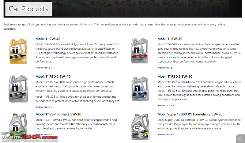

Mobil Delvac is Mobil's heavy-duty engine oil range meant for trucks and buses and not passenger cars.
This is Mobil's range of engine oils meant for use in passenger vehicles:
Please refer to your owner's manual to verify the specification of the oil recommended by the concerned manufacturer.
By the way, all the lubricants have a shelf life which is approximately 4 to 5 years unless otherwise specified. All the lubricants are a concoction of different kinds of base oils mixed with a number of additives and performance enhancers. Over time these chemicals break down rendering the lubricant unfit for use.
If you're very keen to use Mobil lubricants in your car, please go to the relevant section of Mobil's website and match the specifications of the lubricant that you want to use with what is mentioned in your vehicle's owner's manual.
