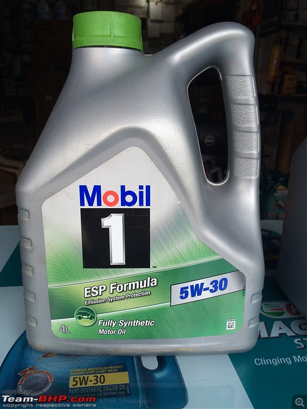

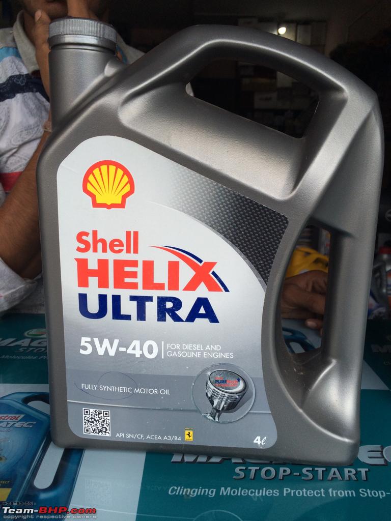

Dear all. I have a 2014 Swift ZDi which has run 60K Kms. I was in market recently for change to synthetic oil. After going through multiple threads I had decided on Mobile Delvac -1 ( 5W40). Also research on Team- BHP revealed Raka oil to be a good source for knowing authorised dealer. I went personally @ Raka Oil in Chinchwad and indeed was promptly attended by a assistant there. However I was informed that Mobil Delvac is for truck use and not to be used in automobiles. Indeed when I went to the dealer I was given following options:
1. Shell Helix Ultra ( 5W40)
2. Mobil 1 ESP Formula (5W30)
3. Mobil Super, MGDO(5W40)
I opted for Mobil Super MGDO ( 5W40) since that felt to be the safest bet. Also Shell Helix was almost twice costlier than Mobil Super MGDO. I am attaching photos for benefit of others. I have following questions for pundits on forum:
1. Can Mobil Delvac-1 be used in automobiles?
2. What is meant by MGDO, does it mean that oil is specially made for the said engine or is it simply endorsed as a marketing gimmick/ to share profit?
3. Which would be the best oil for my Swift( ZDI)? I want something which would keep engine in good condition and also be smooth to use.
4. Shell costs a lot when compared to Mobile. Does it mean it is better oil ?Or is it because Maruti has endorsed Mobil its cost was cut down as it will get more volume due to it being a Maruti Genuine oil?
VIKINGTILLDEATH is offline
I have a Swift Zdi which is due for 60k service as well and I've opted to go with Mobil Delvac 1 5W-40 after trying out Castrol edge and Shell Helix. I think MGDO oil is a semi-synthetic option and many have had good things to say about it.
I opted for Delvac 1, since I found it to the best as per my experience, even after a few months the engine remained smooth and delivered good efficiency.
Afaik, Mobil Delvac 1 is safe to use in swift diesels.
You can go ahead and use Delvac 1 without any issues. I dont see any specific reason as to why one cant use it in small Diesel Engines. In fact, I had used the same on my 2010 Swift Diesel for close to 50K without any issues.
MGDO stands for Maruti Genuine Diesel Oil

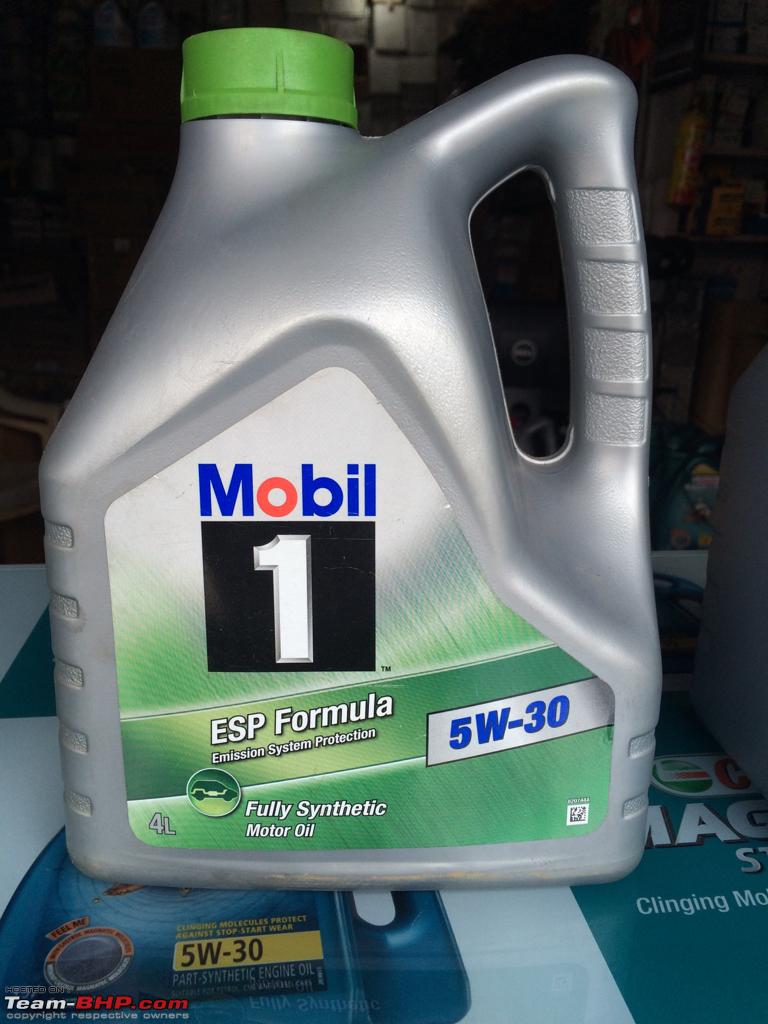

@Shashank :
Mobil super 1 has "Fully Synthetic" written on it. I am posting the photograph of same for benefit of others and also of the other options whuch were showed to me.All about diesel engine oils-imageuploadedbyteambhp1473752156.953368.jpgAll about diesel engine oils-imageuploadedbyteambhp1473752193.418163.jpgAll about diesel engine oils-imageuploadedbyteambhp1473752234.190263.jpgAll about diesel engine oils-imageuploadedbyteambhp1473752252.342752.jpgAll about diesel engine oils-imageuploadedbyteambhp1473752270.659571.jpgAll about diesel engine oils-imageuploadedbyteambhp1473752285.811434.jpg
