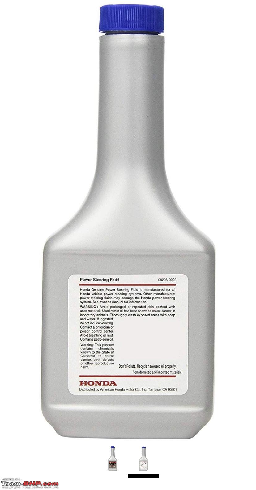

Since the last week or so I am getting a peculiar whining sound which seems to be coming from the engine upon acceleration. Got my 2010 Civic automatic serviced on 3rd March,2020 at around 44xxx kms. A normal service was carried out, where they replaced the engine oil, filter and whatever else they do. There were no unusual findings reported by the Honda service centre either. After this, the car has hardly been driven 100 kms due to the Covid situation.
What could be the issue here? Has anyone faced a similar situation? Advice would be much appreciated.
Could be due to low Power-steering-fluid, I had a similar problem in year 2011. A Whining/Whistling noise when I was going up the hills (Mettupalayam to Ooty). When the fluid was topped up the noise vanished.
Don't know why low Power-steering-fluid creates this noise though.
Thanks a lot Manim!
How do I check that and is it easy enough for me to top up? I would like to avoid going to the service centre as far as possible right now.
Is this good enough or you recommend something else? It’s available on Amazon.in for 9xx rupees.
it is easy to check the levels, it is on the RHS of the car in a transparent container, it is on your LHS when you open the bonnet.
It was topped up by the HASS, and the level never dropped again in the nine years after that incident.
Spot on! The power steering fluid was the culprit, the fluid was significantly below the indicated lower level in the reservoir. As per the instructions mentioned on the reservoir, I topped it up to the upper level and the whining noise on acceleration is gone.
I have never checked this level in ten years of the cars life and evidently the Honda Service Centre also don’t bother to do that, as my car was serviced in March.
In case anyone has an issue with an irritating whining noise on acceleration do check the power steering liquid level first before anything else.
Thanks once again Manim.
