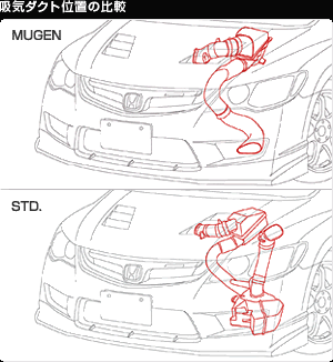

Are you saying that the intake pipe was damaged in between or had a tear or something from where the water was able to get sucked inside the engine there rather from the main opening which is near the battery? What are the various parts Honda is quoting for? As always in case the quote is on the higher side seek a second opinion.
Edit: Attached a pic of the intake. Can you mention where it sucked in the water from? I am just trying to understand the cause, since even I have driven the Civic in water logged area last year.
It is possible, the resonator box is very near to the plastic under body protector. There are holes in the resonator box, and probably water could enter via that, and get sucked in though the final air filter and intake to the car is at bonnet height.
I had a habit of breaking the resonator while on my wild drives and for this reason I was pretty cautious not to wade in water once I saw that resonator box.

Attachment 1918096
Thanks, Sumeeth for sharing the pictures. This is exactly what I was talking about.
The water seems to have been sucked in from the resonator box. The same was also mentioned by the Honda technician. As you will notice, the resonator box is located way below the actual intake and is somewhat at the mid-tyre level i.e. the height of water which I was trying to drive trough.
Thanks, Laluks.
Thanks for pointing out that the resonator box has holes in it. I believe the same would have been the entry point for water. I was under the impression that since the air intake is actually located higher, the civic will be able to wade through mid-try depth water. Learned something new the hard way.
