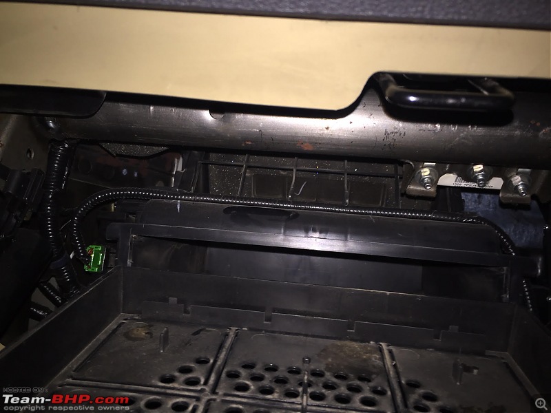

Yesterday I happened to open the pollen filter cabin only to figure out that the filter itself was missing and was filled with old dry leaves. Is that the case with others? I have seen cabin filter for sale on Amazon for Rs.675. Planning to order one here:

^^ not sure about the facelifted 2009+ Civic, but mine doesnt have a cabin filter as OE fitment. There is however the provision for adding one as it is available for international variants.

@aa_asif; The Indian spec Civic does not have the filter. I bought mine on the net (FRAM with Carbon) on the web for 2000+. Now the 675 unit looks like a steal. I hear the filter is the same as in the Accord. When I checked at the Honda ASS while the exploded drawing shows the filter housing, it is not even listed. So get your own and put it in, is the only way. Very surprising since the City has one. In the Brio the housing is moulded into a single piece so you can't even add it.
