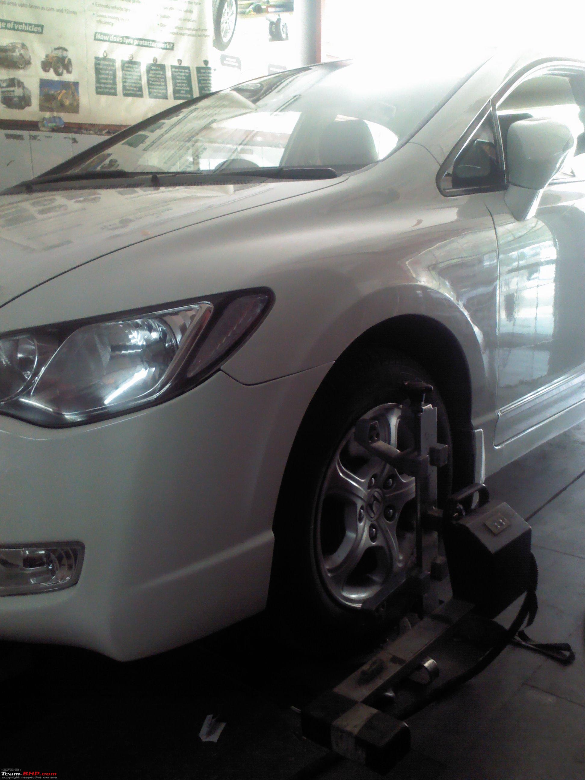

Good evening fellas!
I got the wheel alignment and balancing done on the car, on Tuesday, the 21st of Jan.
After that, I drove the car back home and it stayed there till last evening, i.e. Friday, the 24th, when I took it out, after 3 whole days.
Now, here's the problem and the surprise/shock/confusion regarding a panel gap that has emerged between the LHS fender and the passenger door. It just appeared there. Out of nowhere.
While the car was undergoing the alignment+balancing treatment, there was no sign of any sort of damage/fender bender/panel gap. Below are the pictures from when the car was at the wheel alignment center.
Honda Civic : Maintenance, Service Costs and Must dos-img1970.jpg
Honda Civic : Maintenance, Service Costs and Must dos-img1972.jpg
As you can see, the surface appears absolutely smooth and also, there was not difficulty opening the door either.
However, when I tried opening the LHS passenger door last evening, it made a cranky sound and on further observation, I noticed that a panel gap had 'developed' causing an obstruction that wouldn't let the door to be opened completely!
The car is always parked in the front yard of my house, which has a concrete compound around it, so there's no way someone would have banged their vehicle into mine and zoomed away. This is the only car that gets parked inside the compound. There are no dents/scratches/marks on the fender or the LHS door either! Here are the pictures for that:
Honda Civic : Maintenance, Service Costs and Must dos-img1976.jpg
Honda Civic : Maintenance, Service Costs and Must dos-img1977.jpg
Honda Civic : Maintenance, Service Costs and Must dos-img1978.jpg
I am absolutely clueless as to what might have caused this panel gap! I need some inputs as to what might have led to this and also, if anyone else has experienced something abnormal like this before! Please help.
