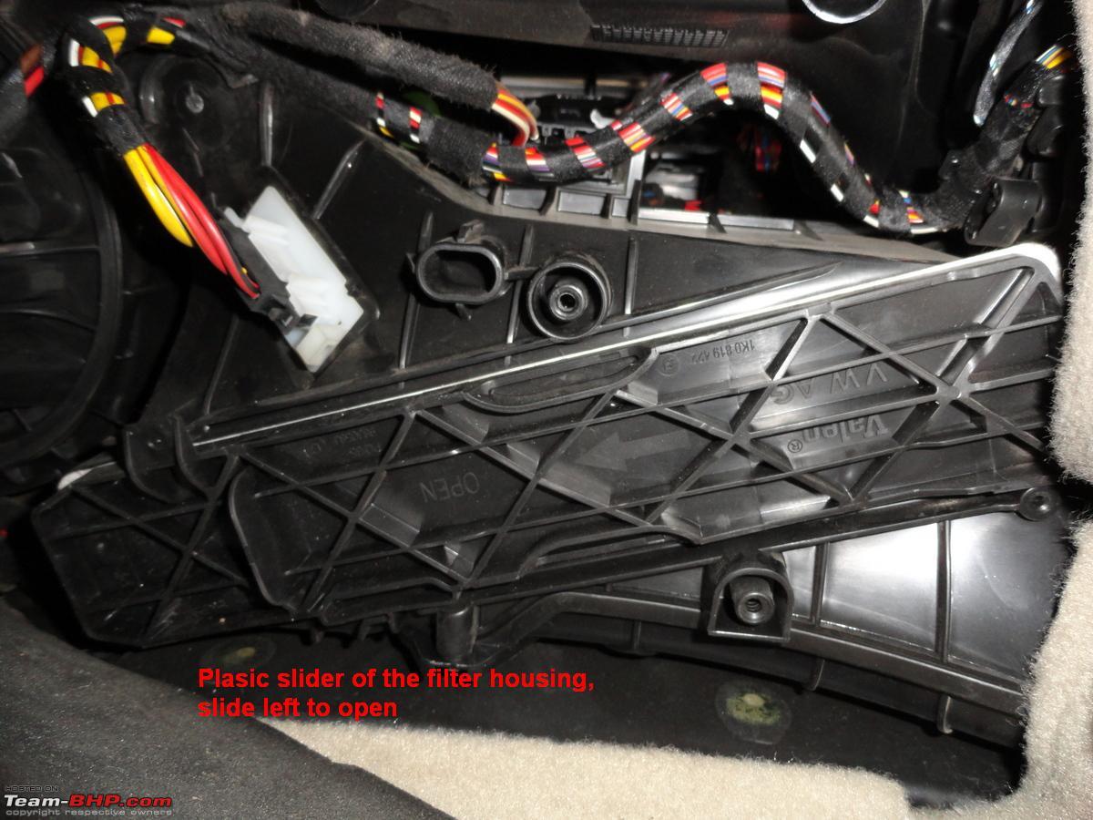

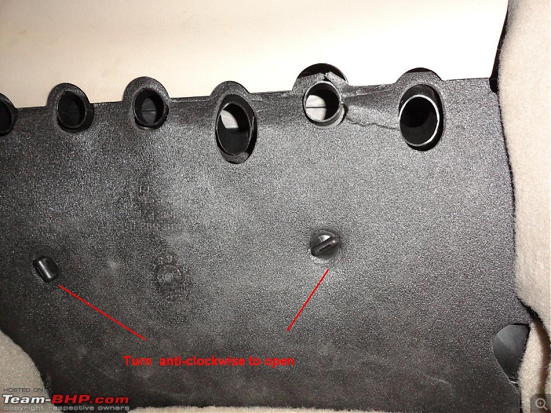

OK, I tried to remove the foam cover but was not sure how exactly should I remove the screws. So instead of trying anything stupid, came back, googled and found an excellent video:
Now I will try this and report.
anandpadhye is offline
Old 15th December 2012, 13:36   #428
Posts: 3,060
Thanked: 3,346 Times
Done, i removed, cleaned and re-installed the cabin air filter!!!
Done. Removed, cleaned and re-installed.
Feeling good about myself.
Now I can order the filter online and replace it on my on going forward.
Some pics:
Skoda Laura: Problems & solutions thread-01_foam_cover_below_glove_box.jpg
Skoda Laura: Problems & solutions thread-02_foam_cover_screws.jpg
Skoda Laura: Problems & solutions thread-03_foam_cover_remove.jpg
Skoda Laura: Problems & solutions thread-04_plastic_cover_sliding.jpg
Skoda Laura: Problems & solutions thread-06_cabin_filter_pulled_down.jpg
Skoda Laura: Problems & solutions thread-08_filter_part_no_orientation.jpg
Skoda Laura: Problems & solutions thread-09_view_from_below_filter_removed.jpg
anandpadhye is offline   (3) Thanks
