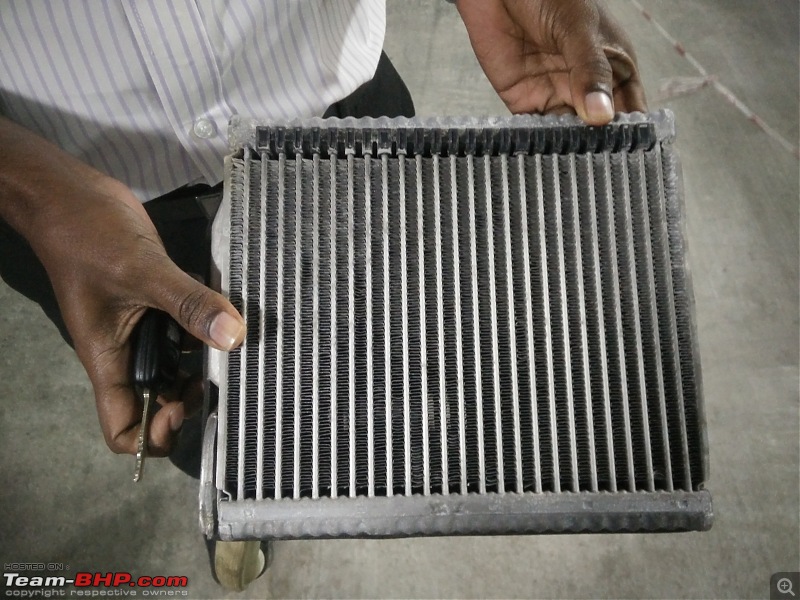

I also faced ac cooling issues recently in my 2012 model Brio (47000KM). Did a search for related threads and got this one straight away. So there were couple of options, where I could take the car for diagnosis.Decided to visit Rajan Auto AC mechanic in OMR (very close to my place) and took the vehicle there today morning.
The initial analysis showed the high pressure range ~130psi & low pressure range ~30psi which gave an indication of refrigerent gas leak. The compressor was running and no visible leaks observed around which helped to rule out possible compressor clutch/bearing/coil issues. Also no clogging observed on the running lines as well.
Based on these observations, he gave me an indication of leak in evaporator cooling coil which is placed under the glove box. Finally pulled out the cooling coil and it was found to be in extremely dirty condition with milld leaks at few places. Hence he suggested me to replace the cooling coil.
The overall price quoted Rs 4000 (cooling coil) + 1400 (134a gas fill) + 1000 (labour). I was just curious to know how other guys are quoting and enquired immediately. Called up Suresh (Tnagar/Kodambakam)- 5 to 5.5K for cooling coil spare alone. Also called up Captial Honda service and found the pricing very interesting.They are charging only Rs 2600 for the spare. However the trick lies at the overall charges which would come around 7.5 to 8K including gas refill and labour. Also the spare wouldnt be readily available and have to get it imported from Noida/Mumbai.
Few fellow BHPians here pointed out few stores here in Chennai where I could directly buy the spare, however didnt try it as it is difficult for me to skip office and go around. also not sure whether I could get the correct/genuine spares by myself.
Hence I informed Rajan to get the spares and finish the job today itself. The work was done by evening and I took the delivery after office hours. The cooling seems to be really nice and chilling now. However I would inspect it further tomorrow during day time and confirm.
As already mentioned by fellow BHPians, a cabin air filter would have saved the cooling coil from accumulating dirt and would have increased the life span. As per Rajan experience, Maruti is found to have larger life span (8-10 years) for cooling coils and Mahindra the lowest (2 years). However the compressor life spans for Maruti is not that great. End of the day you would end up spending some way or other.
Check if the international brio versions have the cabin filter option or if you can retrofit one.

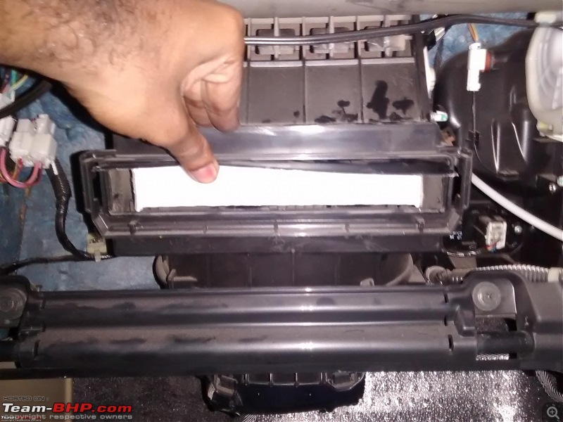

Brio (and Amaze) both have a plastic box behind the glovebox where the cabin air filter normally goes. The problem is that the box is dummied by a small plastic strip at the front.
This plastic strip can safely be removed, fit the cabin air filter in and then use cellotape or whatever to sit the plastic strip back on.
The filter you need is the same one that fits the honda jazz / city 3rd generation - take the cabin air filter to an auto parts store and show it to them so they can get you a replacement, ideally buy a good brand like Purolator rather than cheap local brands.
