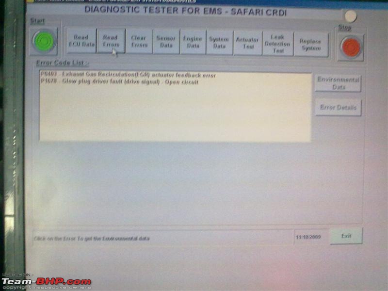

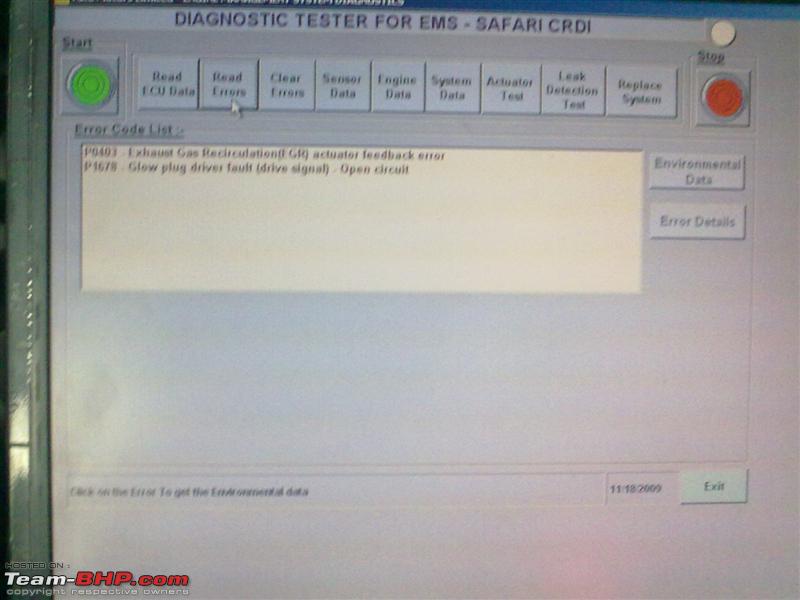

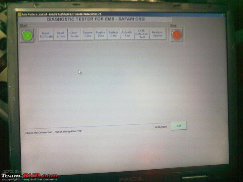

EMS Software for Safari CRDI
Happened to click some pics of the "Safari Engine Management System" Software in action , so thought that I'll post the same. Pics are from my cousins 3L, which has a suspected Electrical harness short as the ECU was returning a different fault with every start!!!!!
The Tata Safari 2.2L Technical / Problems Thread-1-medium.jpg
The Tata Safari 2.2L Technical / Problems Thread-2-medium.jpg
The Tata Safari 2.2L Technical / Problems Thread-3-medium.jpg
The Tata Safari 2.2L Technical / Problems Thread-4-medium.jpg
