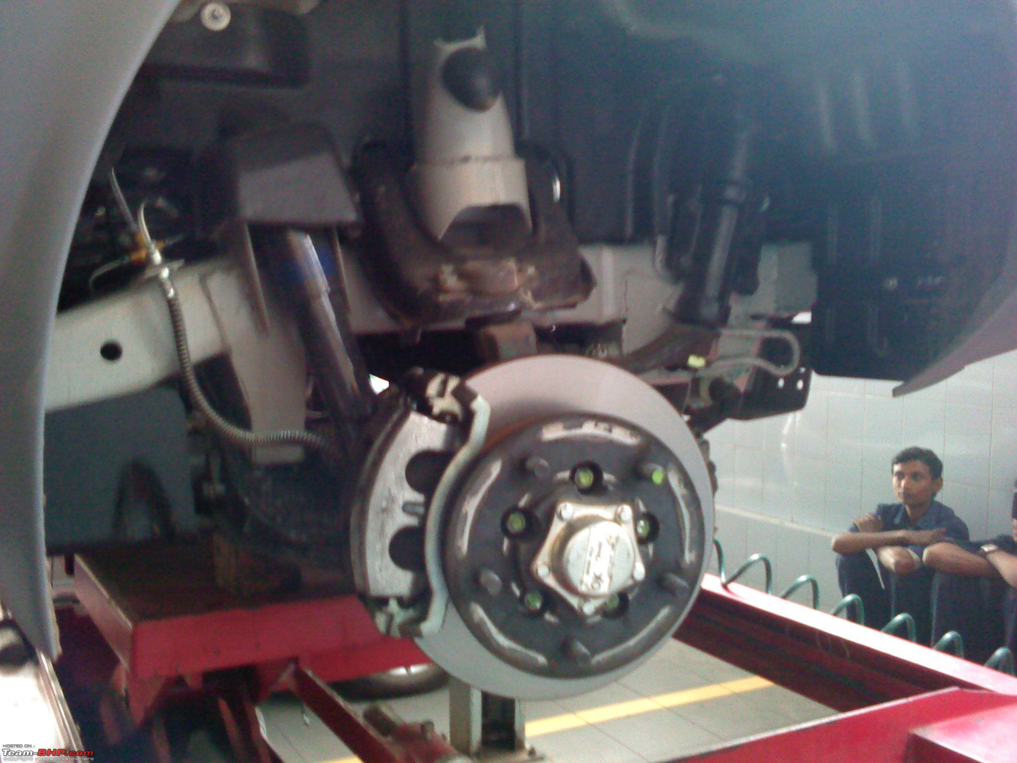

I have a question:
Picked up 2.2 LX Dicor last Tuesday. While braking at higher speeds ~80kmph, I felt the vehicle pulled to the left. Went to the service advisor and reported the issue.
The technical experts aka technicians/mechanics removed the front wheels, took out the brake pads, scrubbed them with sand paper and put them back on. Bleeding was an option they were considering, but suggested that I drive and test it again and come back if the issue persists.
Now though I did not get a chance to go beyond 60 kmph is the Delhi traffic, but I noticed that the acceleration is smoother. Has smoother acceleration got anything to do with what the technicians did?
Please enlighten me.
The Tata Safari 2.2L Technical / Problems Thread-pic081.jpg

Originally Posted by ItMyLife View Post
I have a question:
Sri,
When I last drove your vehicle, the braking issue was there even at speeds of ~ 60kmph. When you come to my place or drive to your office, try a little bit of hard braking. That'll let you know if the issue still persists. As mentioned in the morning, maybe the sanding freed up brake pad a bit. Just my 2 paise on it. I'll leave it to the gurus for their feedback.
BTW, this looks like the front right wheel. The pic should have been of the front left wheel!
I have a question:
This is a common problem. I am facing this problem from the day one! I got my EX some 15 days back. Till now, all they do is pt out the brake pads, rub them and put them in again. But issue havent solved at all.
Now what they did last time, they removed some black color steel plate from the brake pads, the mechanic was saying that its for the gap between pads. After that he did a test drive and said its better but not completely resolved. I am not sure about the same as I am having fever from a few days and not able to drive the car. Will check it in a day or two.

Dear Godfather and ItMyLife you have an alignment issue ask those idiots to check the wheel alignment and do the "Shim" adjustment.
I would advice stand over their head when your vehicle is on the ramp for alignment and check that Caster and Camber values are with in the range.
If in the print anything is shown in red that is causing the problem do not buy thier reasoning " ki is se kuch nahi hota"
After alignment go for test drive and a level road. Even if it is pulling the person with you on test drive will try to convince you that it is due to road not being levelled the key is that you should not feel any effort on your tricep to keep it straigt. Going after a workout can help detect this very easily LOL.
Break pad cleaning can not solve this issue.

Its a Front Left BRAKE CALLIPER ISSUE. Please ask the TASS to change it and check.
After getting the same rectified from TML, the issue hasnt comeback in last 8000kms on my safari
