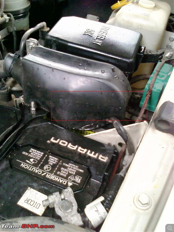

Originally Posted by chaxy View Post
Thanks Guys, i Will be taking my vehicle tomorrow to the TASS workshop. I will update after its done.
This was a new addition - ECU DUST COVER. I am sure it was not in there before.
The Tata Safari 2.2L Technical / Problems Thread-ecu.jpg

OK Got my 2nd service done at Concord Hosur Road along with upgrades.
Upgrade details :
1. Timing belt Kit B upgrade
2. ECU Cover
3. ECU Reflashing
4. AC Condenser fuse.
After ECU reflash there is no major dramatic change but the turbo kick has disappeared and the power delievery is smooth.
