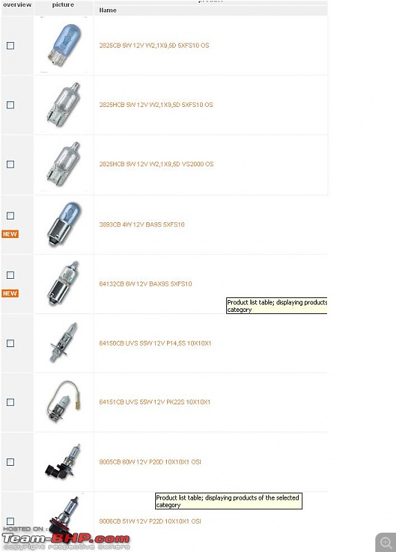

I want to change the front fog lamp bulbs and the front parking light bulbs to the white/blue types. Osram sells these, but I'm not sure about the specs. I have a pictre of the bulbs ofered by Osram. Hope someone can help me out here.

Regarding the bulb, please check the wattage of the Fog Lamp bulb from Owner' manual or by taking out a bulb from the forg Lamp and buy the one from Osram with same Wattage and specifications. I have forgotten the specs but the 3rd bulb from the bottom looks to be the one used for fog Lamp.

As for fogs its 55W H3 which goes in Safari. It available from normal parts shops for 80-90rs/pair(Osram)

I shall get the wiring/earthing thoroughly checked on my first service. I also thought that the third last bulb should be the correct one for the H3 lamps.

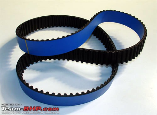

3) Timing belt changed
The Tata Safari 2.2L Technical / Problems Thread-timingbelt.jpg

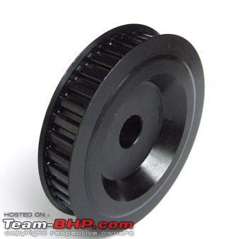

4) Timing Pulley/s changed
The Tata Safari 2.2L Technical / Problems Thread-timingbeltpulley.jpg

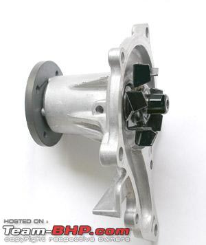

7) Water pump was leaking into the timing belt casing, minute leak but visible due to the white marks inside the cover, changed.
The Tata Safari 2.2L Technical / Problems Thread-water_pump2.jpg

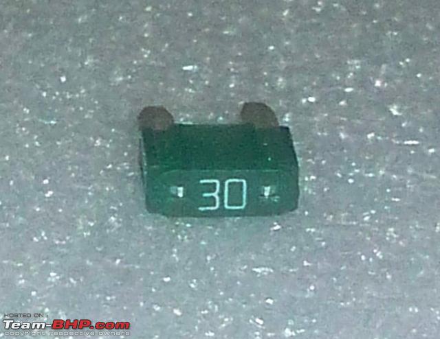

box, again reported here first.
The Tata Safari 2.2L Technical / Problems Thread-30a-condensor-fuse.jpg
