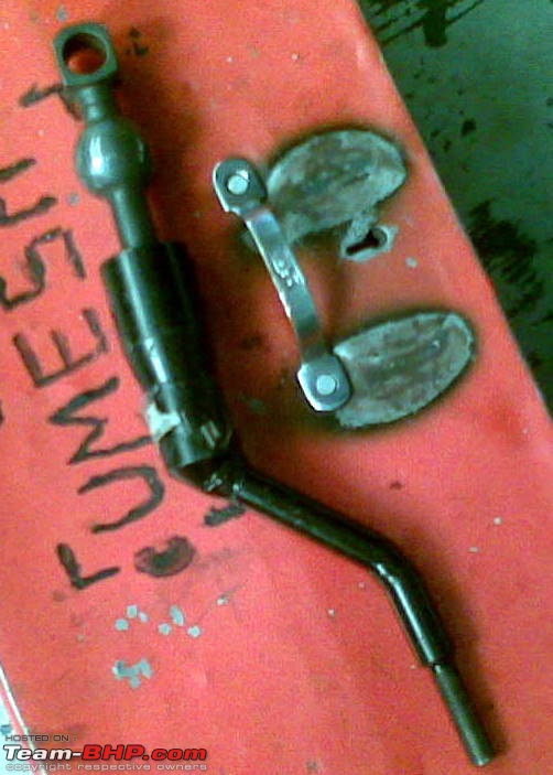

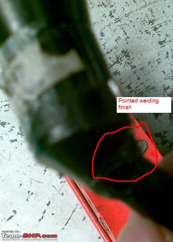

Posting few pics. TASS has replaced the gear lever (rod)- because they noticed that welding on the bent had some projections and they suspected that rod may have been bent causing undue stress on the leather boot cover.
Changing the rod was quite a job. They took almost half a day to do it. The truck had to be lifted up and then remove bottom protection plates (two of the three), undo differential assemblies and access the gear box, etc. When I visited the workshop they were putting back the stuff. I got to see my truck's bottom naked . It looked quite strong built. The 4wd transfer case was well hidden behind a x-member and protection plate. The plates itself looked like 4-6 mm sheets. The bar code tags stuck on the components from TML felt reassuring that my truck is still new :-). The guy (Mr Umesh) attending the job admitted that due to extra FWD differential it took him longer than normal 4x2 safari.
Anyways, the gear lever is changed now with a new bush. Gear change feels little notchy than before (to get into 1st and 2nd gear). Mechanic told me it will settle after some run-in. My truck had already done ~1750kms on old OEM lever.
Let us hope the original torn-boot issue is resolved now- which I will only know, if they replace the boot cover. Beige color was not in stock - have to wait till it arrives :-(.
As a side learning, now I know how easy it is to replace the gear lever boot cover and the knob. The plastic panel with leather boot cover is just a push-fit on to the base. It is a easy DIY job :-)
