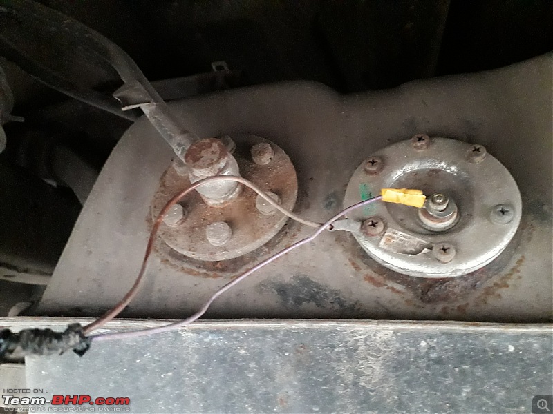

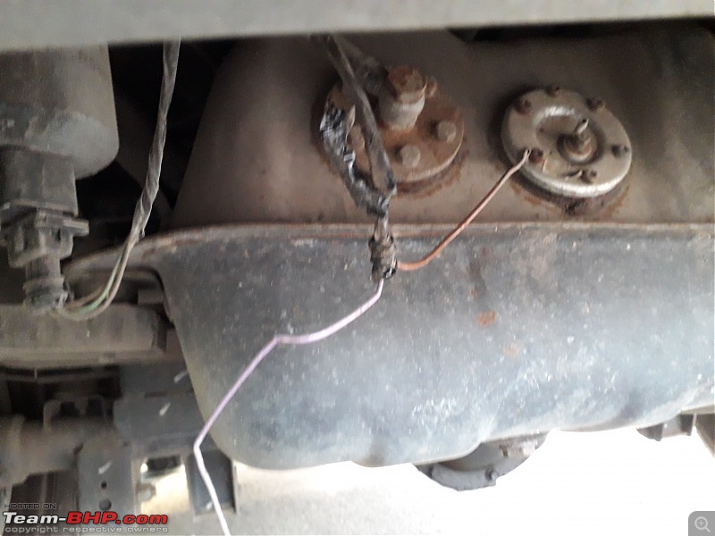

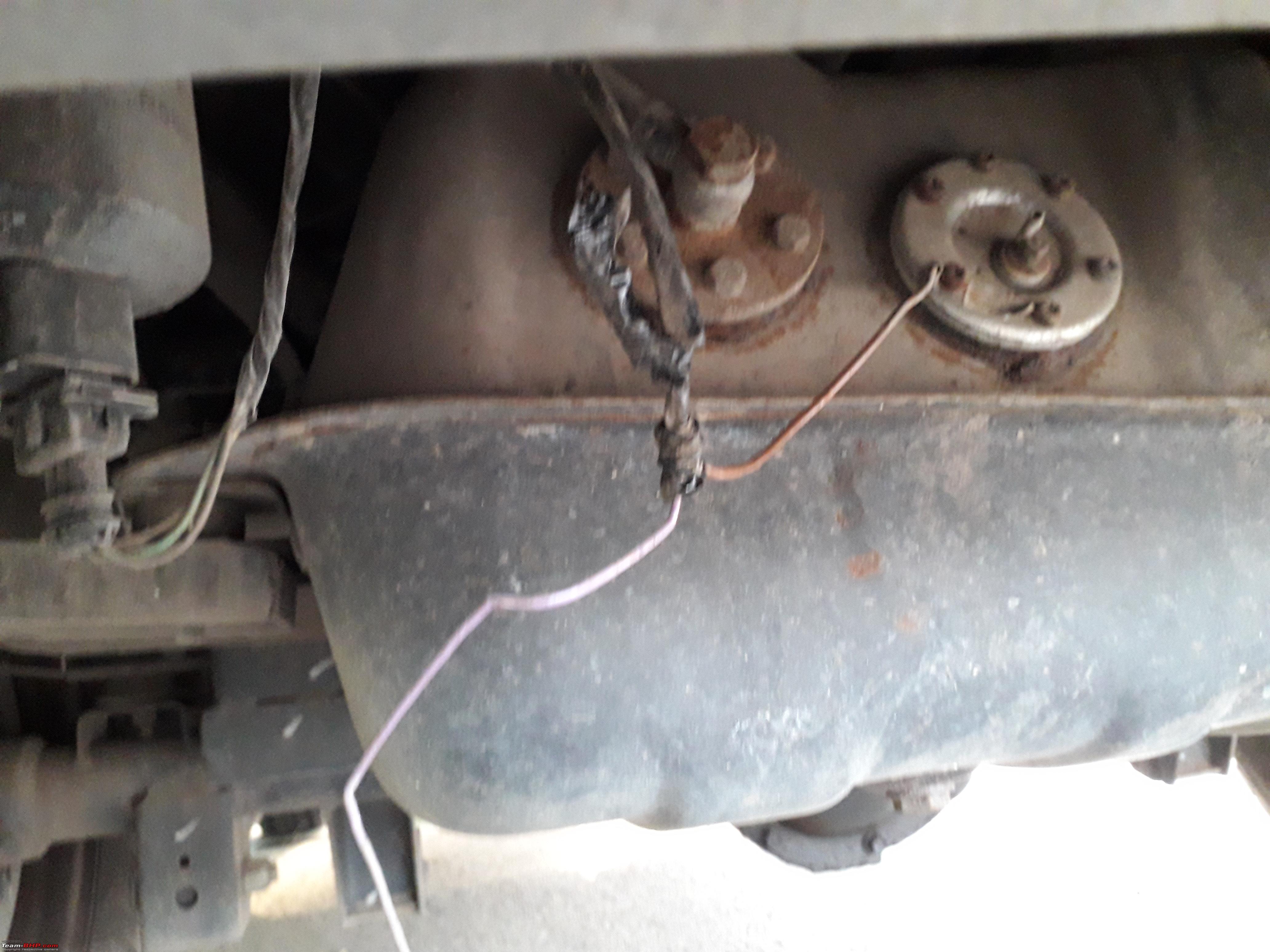

I checked the fuel level sensor on the diesel tank and found that the signal wire had broken from the connecting lug and was floating free.
Most fuel gauges in use are the float and variable wire-wound resistor type and the slider is connected to the central (signal terminal) the other terminal being negative or chassis ground.
I crimped a new terminal lug onto the broken wire and reconnected after removing the old lug. Now all that remains is to cover the wire with a piece of spiral sleeve and anchor them with a cable tie to the diesel feeder pipe port located next to the sensor so as to provide strain relief.
The fuel gauge now shows close to a full tank after restoring the connection. Some pictures are attached.
The Tata Safari 2.2L Technical / Problems Thread-broken-signal-wire.jpg
