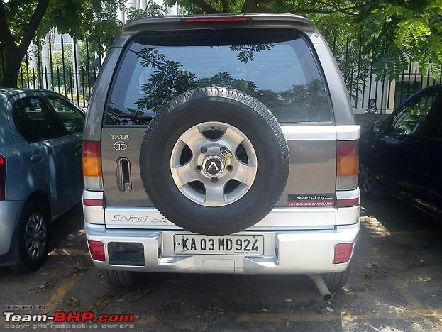

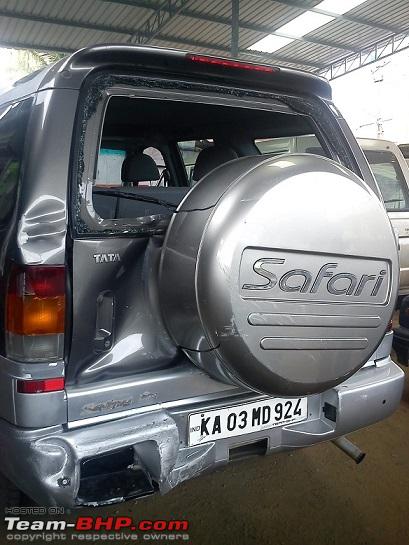

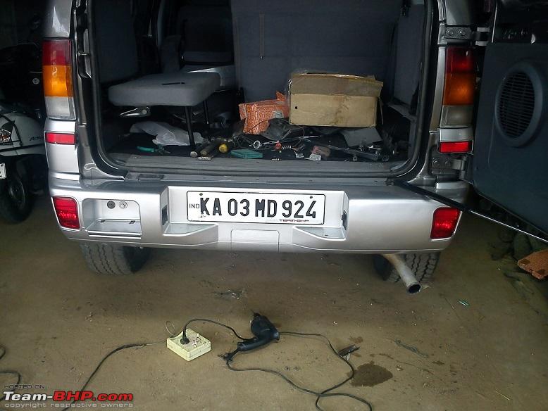

My safari met with an accident recently, got it repaired, thought of sharing some of the Accident & Repari experience.
1. Was hit by a speeding bus. If it wasnt Safari, it would have been fatal.
2. Ensure you get a Police DP ( Petion) at least if you do not want to get into formal FIR & Courts etc , in my case no one was hurt, without this you will not get Insurance amount.
3. TASS gave unreasonable Quote, hence got it repaired from my Local Mysore garrage.
4. Damage was, Rear Glass, Bumper, Spare wheel clamps,Door, completly replaced all.
5. Dont worry about spares, everything is available in Bangalore if you are ready for some search. I even got the rear parking sensors which got damaged, did not want to replace the RD Rear view sensor with Display which i loved than any other Rear view cameras.
6.Need some patience on process of claims. I was insured in Non Private Insurnace & got the claims in 3 weeks ( 10 days from the date of Final bills) which is very reasonable on Non Private sector Insurance.
7. Got about 60% of my spends as my vehicle is 11 Years old.
8. Need to accept losing originality of the vehicle .
