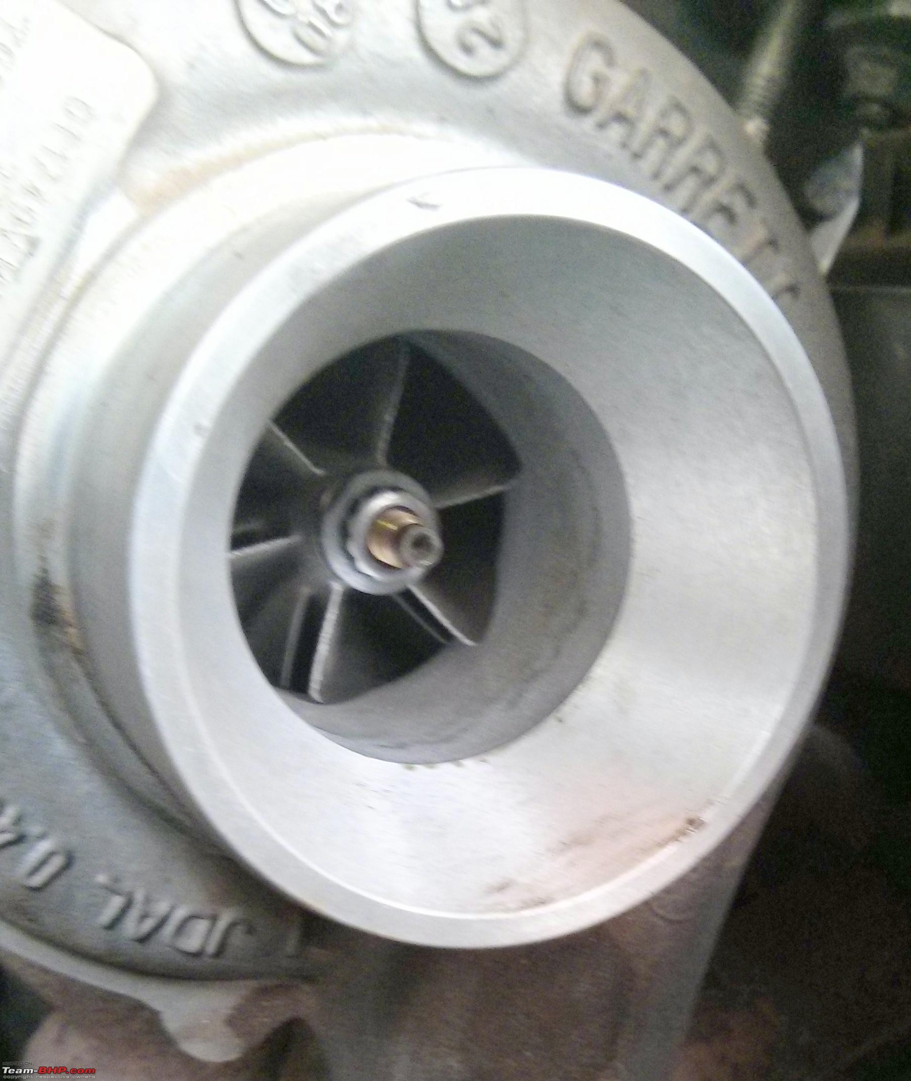

Service light is on again. Speedometer stops working and then the light comes on. Cleaning the speed sensor got rid of the problem for couple of days.
Will take it to service center tomorrow, and and ask them to fix it again.
I am hoping its not a more serious alternator problem, but I guess if it was, a lot more sensors, and not just the speed sensor would be malfunctioning.
How did you get it fixed? My speedo is dead but tacho etc works.
My turbo isnt working too! Was asked to replace it as there is slight shake when you poke it. Will post pix later.
note: no black smoke, no mechanical clatter etc.

Adding picture of turbo. I didnt have my OBD and hence couldnt capture error codes. Will update tomorrow after I get it. Hope its just some small issue and not a turbo failure.
What was the need to do this?
I got the speed sensor changed. Since I had extended warranty it was free.

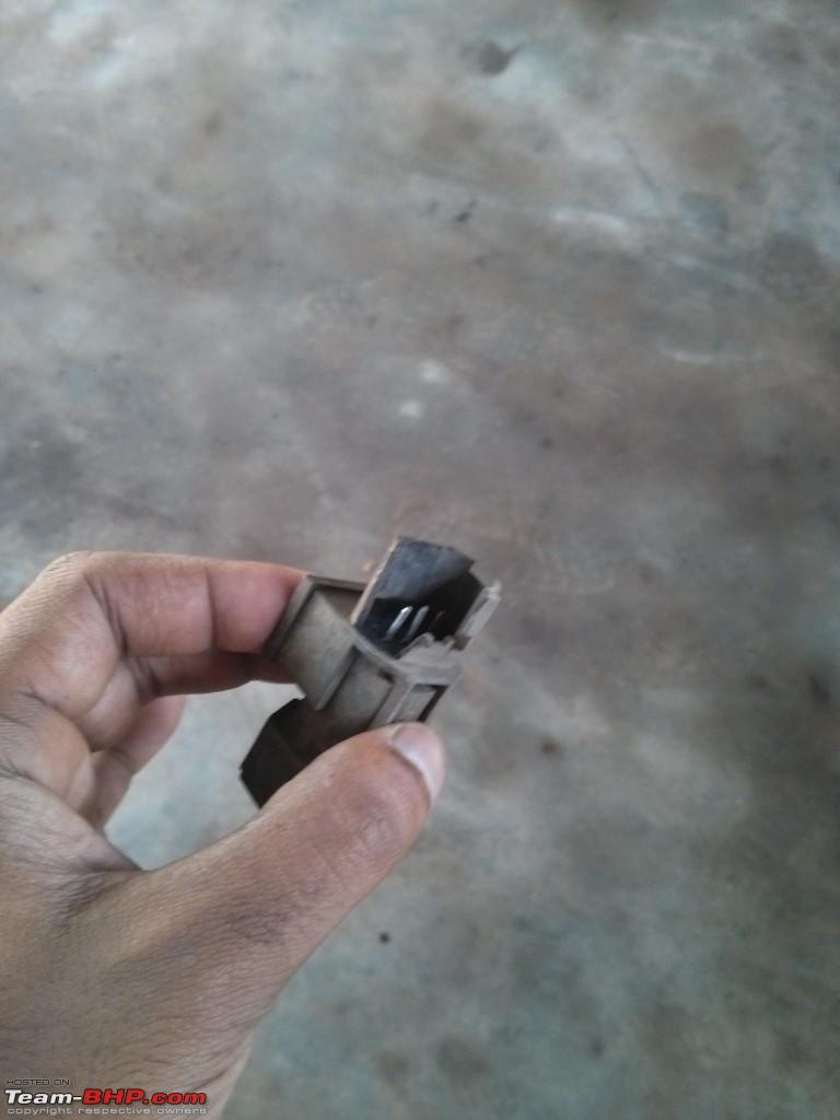

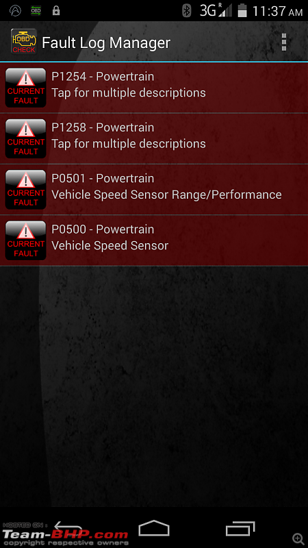

Looks like my dog had fun with the car. Used OBD (Torque) to scan. Sharing the result.
Since we found that the speed sensor wiring/connector was missing, (thanks to scan output), they are reinstalling the turbo back.
P1254 : Rail Pressure Control error. (Pressure error too high) positive present
P1258 : Rail Pressure Control error. (IMV Current trim D...)( High Fuel Low fault) Present
A code P0500 may mean that one or more of the following has happened:
•The Vehicle Speed Sensor (VSS) is not reading (functioning) properly
•There is a broken/frayed wire leading to the vehicle speed sensor
•The vehicle's PCM is not correctly configured for the actual tire size on the vehicl
Tsk's input too helped. We fixed it and all was fine. Parked the car in for the weekend and my dog had fun with Safari again. Had to solder the wires last time since I couldnt get the connector. Also I need to do something to close/seal of that area so that he doesnt crawl in and bite these wires.
