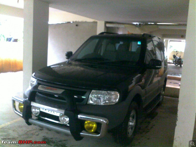

[quote=tsk1979;2886956]The Safaris fog lamps cracked due to water hitting (rain) when hot. Finally, another bout of rain and hot lamps meant that one lost glass.
How much does a pair cost? Can I go for some other brand which can be used in rain?]
I have an LX and now have fixed a bull bar and fabricated some clamps myself as I was not happy with the way accessory guy at TASS (KHT Bangalore) fitted the additional fogs. The original fogs are 55w halogens and beam spread is not good. So I got rid of it and bought myself a pair of Autopal yellow fogs and a 30 A roots relay , 2 coils of 1 sq inch wires, a switch , some fuses and did the wiring and fixed it myself.
The autopal lamps are made of metal lamp housing with thick glass. I have driven the vehicle with lamps on in rain and it certainly gets very hot, but so far no issue of cracking and beam spread is quite good.
The Tata Safari 2.2L Technical / Problems Thread-safari-fogs.jpg
