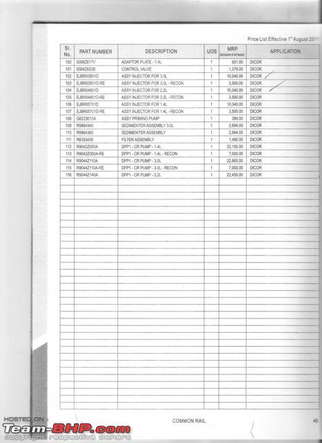

Originally Posted by CRDIsamir View Post
The fuel pump costs around 23000/- But can be repaired at about 10000- 12000. Can you tell me if you face any other problem other then the temperature sensor error ?
Gave the car to Concorde - Hosur Road. The SA vehemently denies that the fuel pump can be repaired. He says it is a sealed unit. Costs 40k.
Waiting for their diagnosis.
smsrini is offline
Old 21st February 2012, 22:27   #4120
anujmishra's Avatar
Join Date: Jun 2008
Posts: 1,292
Thanked: 495 Times
re: The Tata Safari 2.2L Technical / Problems Thread
Originally Posted by somubj View Post
Is there a fix for the window glass rattling?
Yes, keep window glasses closed always. You will not hear rattling sound.
anujmishra is offline
Old 22nd February 2012, 10:51   #4121
CRDIsamir's Avatar
Join Date: Jan 2011
Location: Miraj MH 10
Posts: 125
Thanked: 87 Times
If the vehicle is at the dealership request the SA to hook up the Diamond Diagnostic provided by Delphi-TVS to your vechicle. This diagnostic equipment helps you to determine the condition of the HP pump & injectors. There are two tests, 1. Static test & 2. Dynamic test which are performed. The static test is done just by cranking the engine and measuring the backleakage in the injectors to check the injectors.
The Dynamic test is done by connecting a dumy electronic valve in the diagnostic tool in the vehicle electronics to check the high pressure developed by the pump.
If it passes both the tests then the pump & injectors should be in good condition.
You have also mentioned that the issue is with the Temperature sensor on the pump. Then there is no point in changing the entire HP pump. The temperature sensor is available saperately costing around Rs250/- This should be available at Delphi-TVS.
And yes the HP pump costs Rs22800/- for 2.2 Dicor & Rs22455/- for 3.0 I am attaching the scanned page of the price list of Delphi-TVS for your referance. It is possible that the same costs Rs40000/- in Tata price list.
The Tata Safari 2.2L Technical / Problems Thread-scan0002.jpg
CRDIsamir is offline   (1) Thanks
