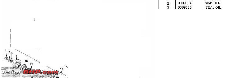

Seal
Originally Posted by cool_dube View Post
warranty booklet says 'Transfer Case - all internal parts' under the 'Covered Items' section and hence leaves room for ambiguity since a seal is not a part, strictly speaking.
Agree about the ambiguity part, but seal is a VERY prominent part.
Originally Posted by dadu View Post
All materials used in any vehicle are parts and are identified by their Unique part no in their inventory. That itself is proof enough that its a part.
Exactly, see an illustrative example (for understanding only) --
The Tata Safari 2.2L Technical / Problems Thread-seal.jpg
Spike
