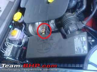

but where this ambient temp gauge is located in Safari ? I did not notice existance of this feature till now.
I have few more requests to Safari gurus.
(a) another stupid query I am little confused on AC recirculation mode after reading the manual , When we press the AC recirculation switch and blue indicator light is seen ( ON) does this mean that AC is recirculating the air or it means that AC vent is open ?
My initial assumption was that AC vent is closed when switch is in off position means Vent is closed and open when pressed.
(b) Can some one point out preferably with picture of engine bay where exactly is AC vent , MY basement parking has rodent issue and I want to
cover it with a metal wire gauge. TASS at Hosur road denined any such possibility.
(c) How to open and clean the Air filter as DIY again a tutorial with pics is requested for benifit of newbies like me, I have never opened air filter box and I am just assuming that big sqare box at the top on right side of engine bay houses the Air filter
Look to the left of the Water tank. Its a 1 inch black coloured pipe turned downwards coming out from the backwall.
The Tata Safari 2.2L Technical / Problems Thread-83240.jpg

Thanks Dadu for the pics , Do you think it is a good idea to cover the AC pipe with wire gauge ?
