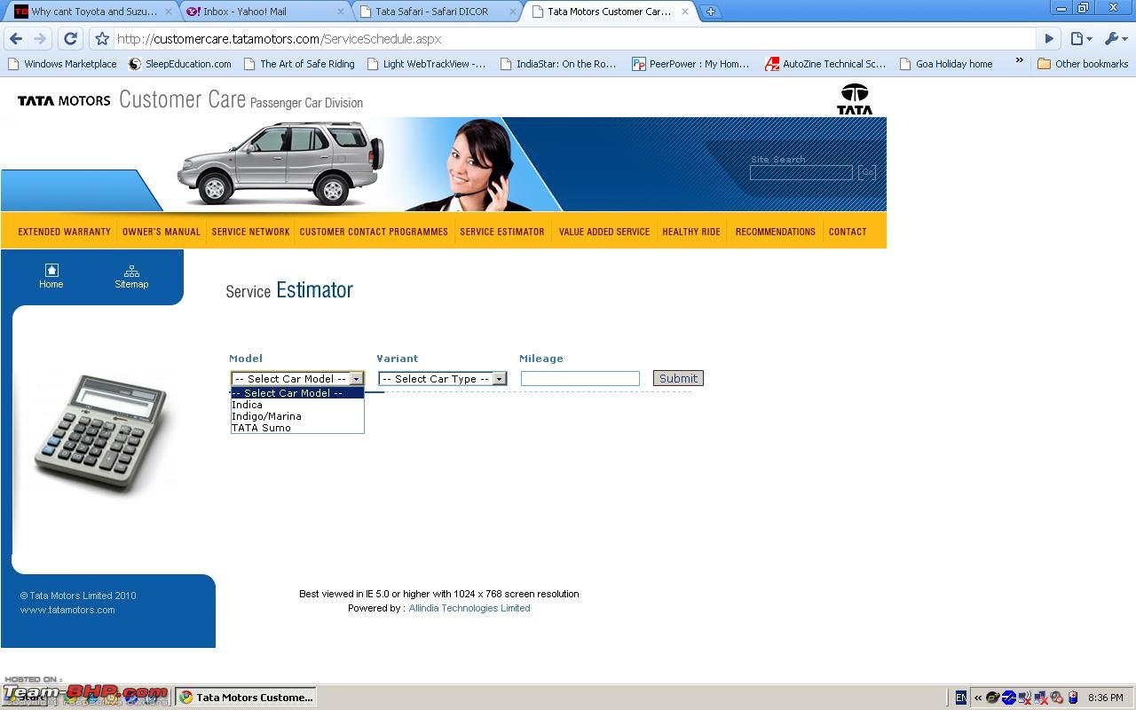

TML Customer Care Goof up
Sorry for the OT post but I thought we should know this:
I was browsing the TML Customer Care site a few minutes ago and landed on the service estimator page here:
Tata Motors Customer Care :: Service Request
And I tried to choose the Safari. What do I find? There is no option to choose the Safari in the service estimator tool.
Does TML too feel that the Safaris are that unpredictable when it comes to estimating what has gone wrong with them??
I have attached the pic as well.
Hey, yet, the pic of the Tata vehicle on that page is that of a Safari..ROFLTMAO...
The Tata Safari 2.2L Technical / Problems Thread-tata_cc.jpg

Hmmm, you're absolutely correct, this is
But why do you feel it is a goof up, I wonder? Maybe it is a deliberate omission? Surely a vehicle customer would be following the regular maintenance schedule irrespective of cost, wouldn't he?
