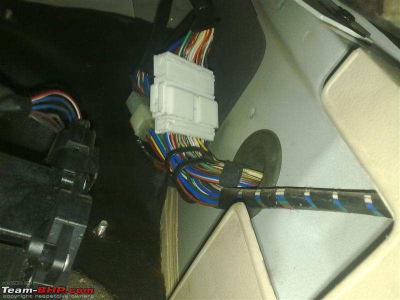

Water leaks inside the cabin near accelerator
Nice. Water leaks inside the cabin near accelerator! I found that water was seeping through some wiring. I couldnt find from where it starts though !
Have pix but for some reason, my uploads are failing :(
Just above the pedal, fold the OEM mat down, there should be one rubber plug, hope its in place. It opens up in the engine bay, right behind the ABS pump.

I'm facing the same problem. But I thought it was because I have the wires of the overhead fog lamp running through the door rubber beading. Even on inspecting that wire I found no water trace, but i thought that was the culprit and was going to disconnect it for the rainy season.
Thanks again Dadu, I'll check this rubber plug first.
