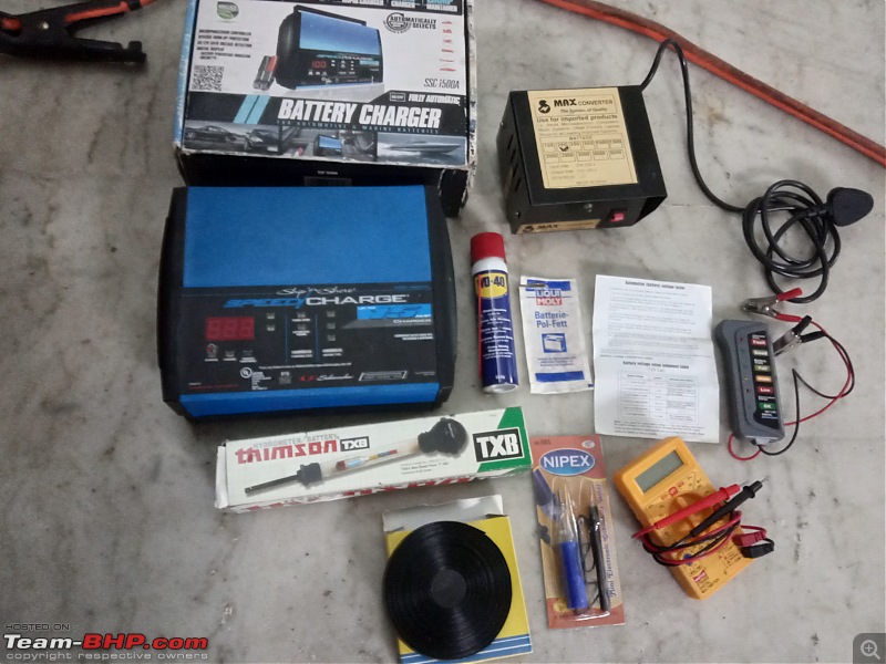

I recently resurrected my 7 year old Qualis battery with help of Schumacher series battery charger (Made in U.S.A) it had been a saviour many times on multiple cars that I own. I have a battery charger but I'm curious to know about the infinitum desulphator. And isn't two days too much for the battery to be charged? I thought after going into trickle charging mode (100% completion of battery charging, probably 2-3 hours of trickle charging is good enough). I did the same with my qualis battery resurrection. It's a 15Amps fast charger, charges a battery 0 to 100% in 6 hours.
This has both slow 3A and fast 15 A charging modes. Along with different battery types. It can charge Standard, AGM and Gel type batteries. It can also charge 24 volts (truck batteries) , never tried though! After charging 100%, this will go into maintenance mode (where desulphation happens on the cell battery plates). After 100 %, it's advisable to leave in this maintenance / trickle charging mode for 2-3 hours. It will revive older batteries for longer use.

All my battery, alternator and fusebox testing tools.

That's a nice battery maintenance kit you have there. Where did you buy the Schumacher charger from?

Impressive tool kit. Do you charge at 3A or 15A. How big is the Battery (Ah). How much current do you recommend for 35Ah Battery?
Hi, Thanks a ton! my Wagon R LXI CNG / Petrol uses the same 35 Ah battery. This 35 Ah battery is most common in almost all petrol cars from Hatchbacks to Sedans.
And addressing your query, it is very simple. If your charger charges the 35 ah battery at 5 amps it just 35 ampere-hours divided by 5 amperes = 7 hours. You have to charge your battery for 7 hours in this case.
Ampere-hours divided by amperes = hours
So if you are charging your 35Ah battery with 1 Ampere output, you should charge it for 35 hours straight.
My Schumacher series Battery charger has 15A (fast charging) and 3A(slow charging) I usually use 3A and leave it overnight. The slower you charge, battery will have better retentivity. So based on calculation, I charge my 35 Ah battery with 12 Volts, 3 Amperes for 12 hours. Charger indicator will show that my battery is completely charged. If my battery is completely depleted or very old, I use trickle charge function, I just keep it in maintenance mode which desulphates all the plates inside the battery. But this did not work on my 4 year old OEM 35 Ah Exide battery. I replaced it with Amaron green in Feb this year. I however revived many Amaron green batteries (on Qualis, Innnova and Sierra) with this charger. That's the only reason I stick to Amaron these days.
I don't excessively charge my batteries as over-saturation by not switching to float charge (this is in case of your charger, as it doesn't come with trickle charge mode) causes grid corrosion on the positive plate. This also leads to gassing and water-loss.
Old OEM Exide battery given brand new by Maruti True value. Served me for 4 years and 25 K kms. (average performance according to me)
New Amaron Flo battery
I bought this for 2900 Rs after 1000 Rs discount for exchange of old battery.
OEM batteries which come with cars directly from showroom (white ones) in general don't last much. Replacement batteries will last longer as per my usage and experience over the years. Hope this information helps you.
