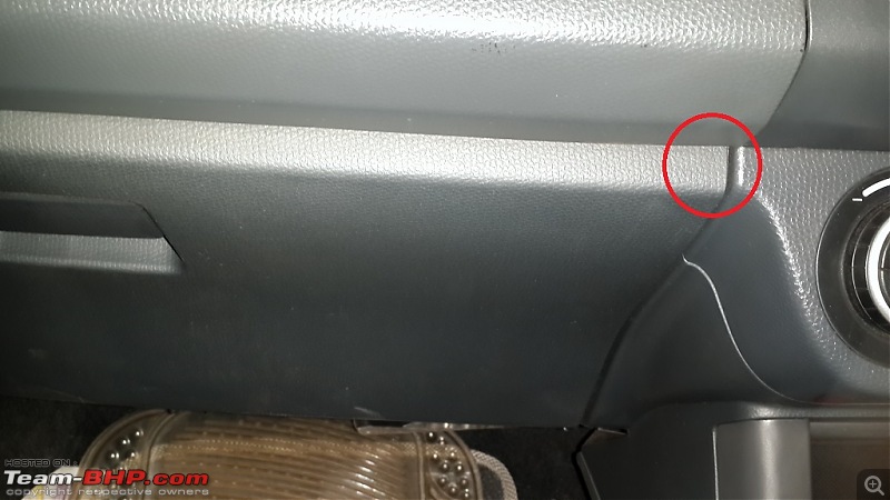

Out of the above list, ASS could solve dashboard, B pillar, C pillar and front doors. C pillar rattling has surfaced again for last one year. ASS is unable to solve it. I am living with it and started ignoring. The creaking noise from C pillar starts as soon as car starts moving in first gear. Door rattling (front door and boot door) will go away after damping as mentioned by everyone. As of now, the most annoying rattle is Glove box cover. The glove box cover makes a vibrating noise while driving. See photos below. Has anyone faced similar problem and solved it? I am thinking of adding some padding at the vibration spot using piece of tyre tube or something similar. Any other suggestions are welcome.
IMO irrespective of the rattling, Swift is absolute fun to drive and I love it. I have thoroughly enjoyed every moment. clap:
The area marked in circle vibrates. If I press the cover then the vibration stops.
