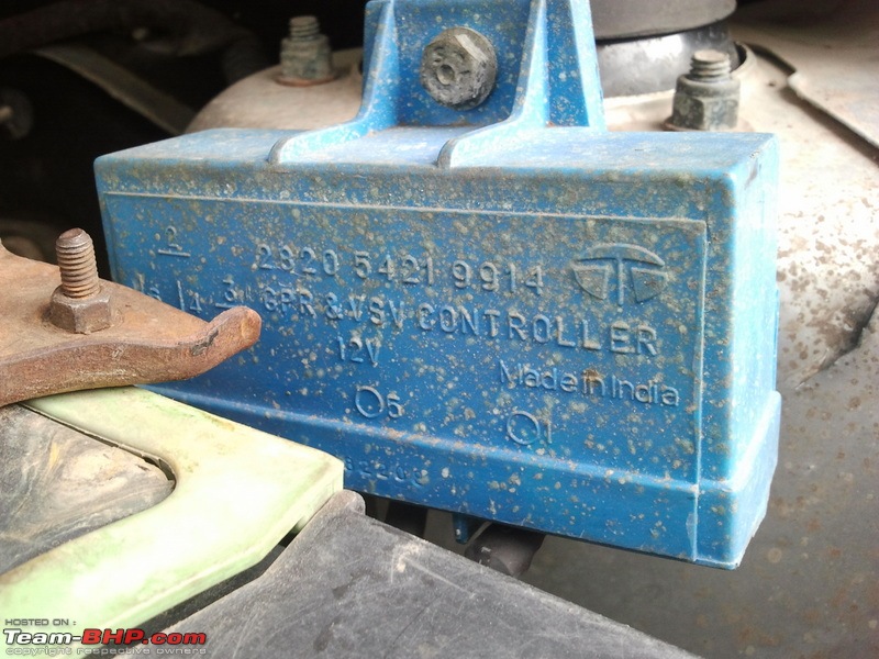

You are correct. The problem should be with the glow plugs or the glow plug timer. The glow plugs and the timer are controlled through the ECU. The glow plugs are on even after the engine starts. This is known as the post heating. I am attaching a pic of the glow plug timer with this post. Also make sure that you put in the timer as per the part number as there is a difference between the timers on the Bharat Stage II and Stage III vehicles.
And yes this could be the reason for the late start of your vehicle as well as the glows plugs do not get hot at all if the timer is dead.
The glow plug timer is located just behind the battery. The cost of it should be around 600-800.

dass, Spark plugs are in petrol cars whereas diesel cars have glow plugs (GPs). The spark plugs work (produce the spark) for the whole duration while the engine is running, where as the glow plugs, become red hot & increase the cylinder head temperature only during the start of the engine.
Since you need 5-6 cranks to start the engine, it means that one or more GPs might have failed. The smoke is from the unburnt gases that are exhausted, as the cylinder temperature is not sufficient to ignite them due to the failed GPs. Since your car is 6 years old & run 60K kms, failure of GPs is not an uncommon thing. I had replaced my first GP after 5 years (car had run 56K kms). That served me well for over a year & then my balance 3 GPs failed @ 80K kms (6+ years). It was then that I decided to replace the full set of 4 GPs, Beru make costing Rs 1400/- & Rs 80 labour charge (Rs 20 per GP) from nearly Lucas TVS. Since then I don't have any starting trouble.
CRDIsamir, I doubt if there is any issue with the GP timer. dass you can check that yourself. When you get inside your car, stich ON the cabin lamp. When you turn the key to ignition position, the cabin lamp dims (due to the voltage drop as the GPs draw good amount of current). The coil symbol on the dash lights up. When the coil symbol from the dash vanishes, it means there is enough temperature in the cylinder heads to start the car (compression ignition of diesel). However the cabin lamp would still be dimmed, which indicates that the GPs are still drawing current. This may continue for 7-10 seconds depending on the engine temperature & the ambient temperature. When the cabin lamp turns to its normal brightness, it means the supply to the GPs has been cut off. Why I explained you this to you is so that you can check if your GP timer is working fine. If your cabin light remains dimmed for 7-10 seconds after the coil symbol on your dash vanishes, them your GP timer is working fine.
AutoIndian is online now   (1) Thanks
The Check Engine should not light up if the Glow Plugs have gone. The Check Engine lights up only if the timer is not working. In the Bharat Stage III vehicles there is a post heating function in the timer. meaning the glow plugs continue heating even when the engine starts unless the specified temperature is attained. Now if this fails untill the sufficient temperature is attained by driving the vehicle after which the ECU signals the timer to stop heating. So the Check Engine stops glowing after 5 - 10 minutes of engine running.
In CRDI & Dicor engines all the 4 glow plugs are controlled through the ECU hence you get the service / Check Engine light if any og the Glow Plugs go
