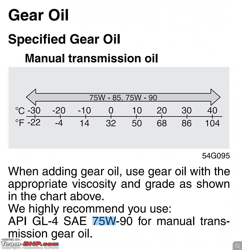

Can someone tell me which manual gearbox oil the Swift/Dzire petrol uses ? The manual just says 75W
Using the MS parts finder and Boodmo doesn't give me a definitive answer as both 75w80 and 75w90 are both available.
Any reason to opt for the 90 over the 80?
It is 75W90. I am attaching the screenshot of the owner's manual of my SX4.
Synthetic Gear Oil-screenshot_20240812004136964_cn_1723403545771.wps.moffice_eng.jpg
Rahul Bhalgat is offline   (1) Thanks
Would this be applicable to the newer models as well ? Mine is from 2018. Im assuming it's the same old gearbox that Maruti has been using in their cars for years. Don't really see many detailed discussions on manual gearbox models.
