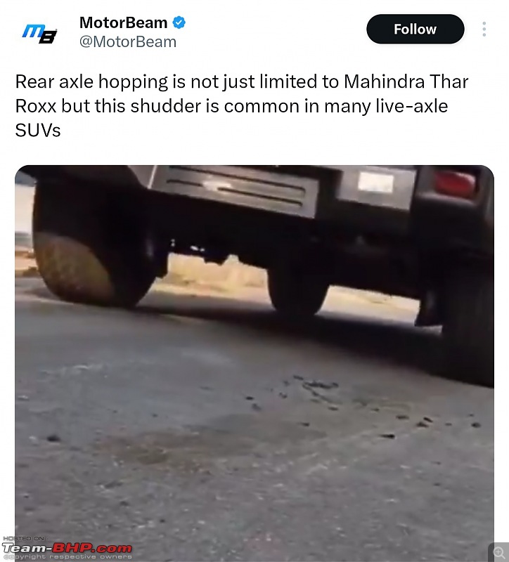

I would like to quote my own post and point everyone towards another post that details similar trait observed across other 4x4 SUVs. So, I don't think it's an issue at all and people should just enjoy driving this sexy home made Jeep
I believe the following post on X from motorbeam handle demonstrates the same:
https://x.com/MotorBeam/status/18519...xQPjwyCdg&s=19
Mahindra Thar Roxx: Rear Axle Hopping / Tramping Phenomenon explained on Page 2-screenshot_20241031_235946_x.jpg
gururajrv is offline   (2) Thanks

This is a very normal phenomenon in almost all 2 wheel drive (mode) fixed axle rear wheel drive vehicle with decent power output. As other video suggests, if one really wants can be replicated in any of the other modern vehicles also.
Just coz someone found the concept of axle hop and decides to make a click bait video out of it, does not really make it a real issue
