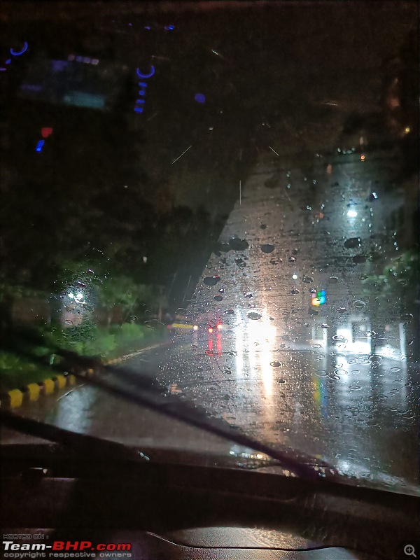

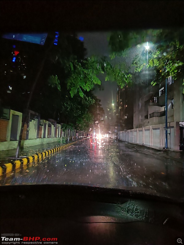

Me and a lot of my friends with cars of multiple manufacturers and vintage are facing a unique issue in the Mumbai Rains.
The windshield during rains always seems to be hazy. Even while using the wiper, the windshield doesnt seem to become clear. (Check video attached).
Things i have tried
1. Wiper usage, Normal AC usage with AC blower on passengers - Doesnt clear the window.
2. Wiper usage, AC on max with blower on windshield - Doesnt clear the window.
3. Wiper usage, AC on Heater and blower on windshield (the windows clear up when heated but the car becomes undriveable, especially since we cant open the windows.)
4. Wiper usage with washer fluid, Normal AC usage with AC blower on passengers - Doesnt clear the window.
My friends with Creta, Ertiga, Innova are also reporting the same.
Can our experienced Mumbai Veterans please help.

You seem to mixing problems on the inside and the outside of the window?
First you need to check where the haze is. If is it inside, then it is a wiper problem. Difficult to see on the video, but I think the wiper is definitely leaving some haze.

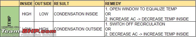

See if the matrix given below helps:
microscopic is offline   (2) Thanks

If I don't use AC, then inside fogs up. If I use AC, then the outside of the windshield gets condensed.
I've been setting the ACC to 30C off late & the problem goes away to a great extent. Plus, there's no fogging inside as well.
