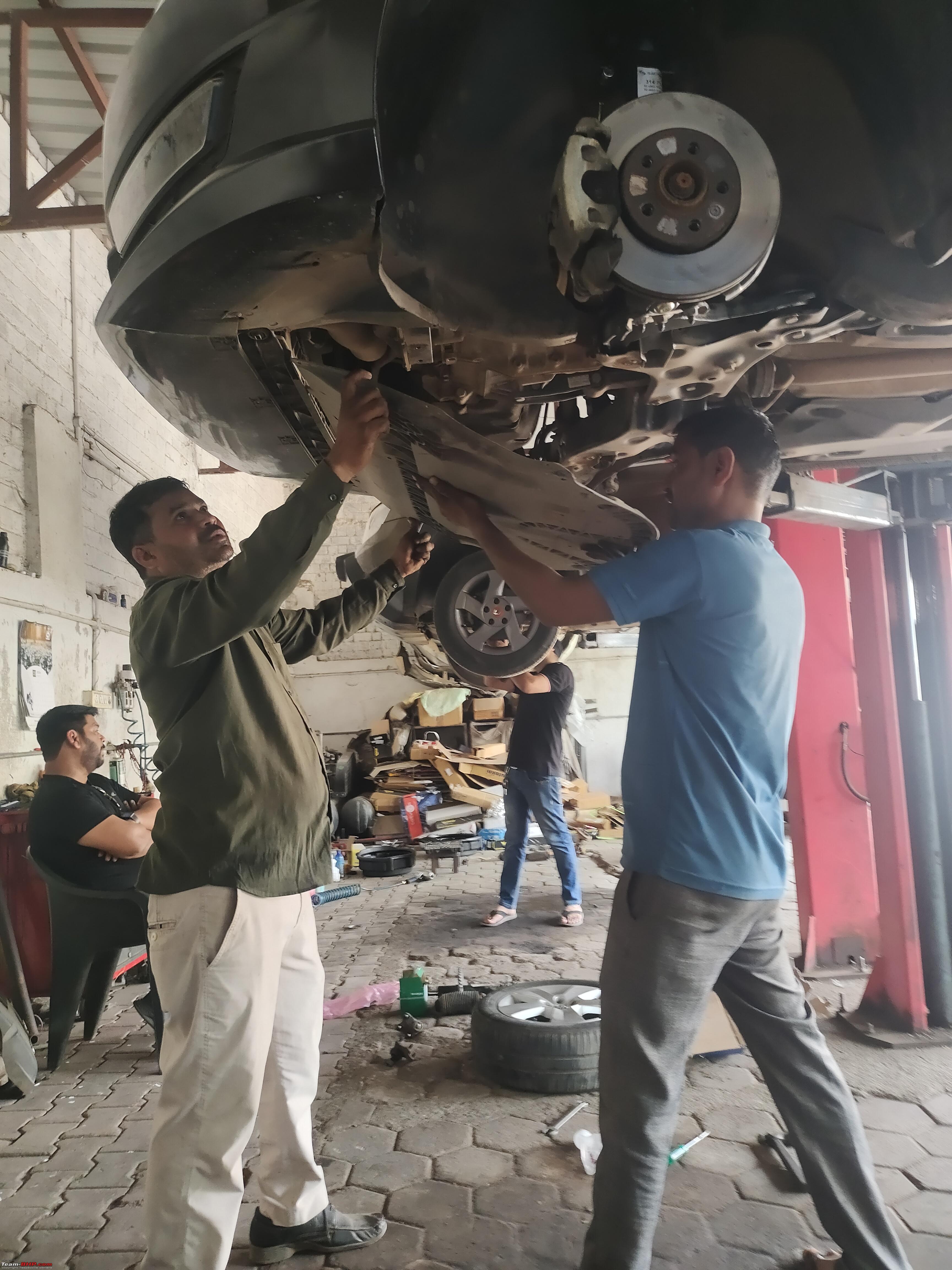

Please find some pictures below-
Review: Sachs Shock Absorbers for my Skoda Rapid DSG-1-workshop.jpg
The workshop in Mahadevghat Raipur

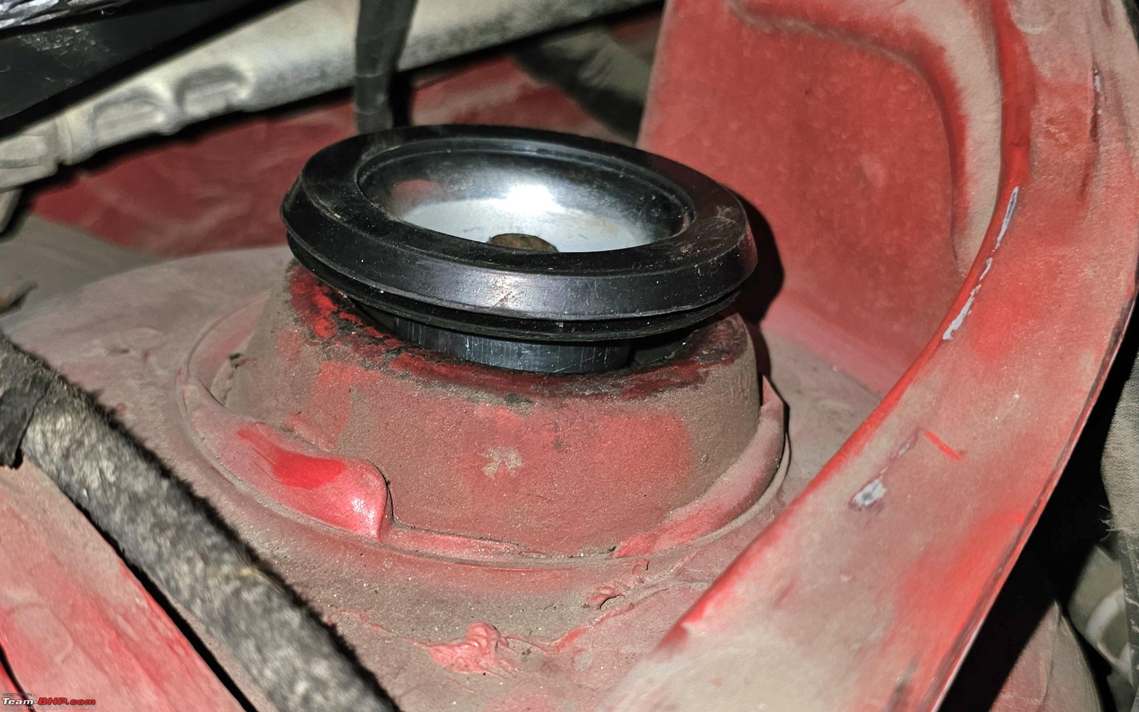

Review: Sachs Shock Absorbers for my Skoda Rapid DSG-2-cowl-broke.jpg
That's how you break the cowl, I asked him to remove the cowl and then work on suspension but he thought he was the expert

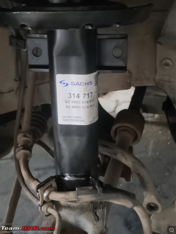

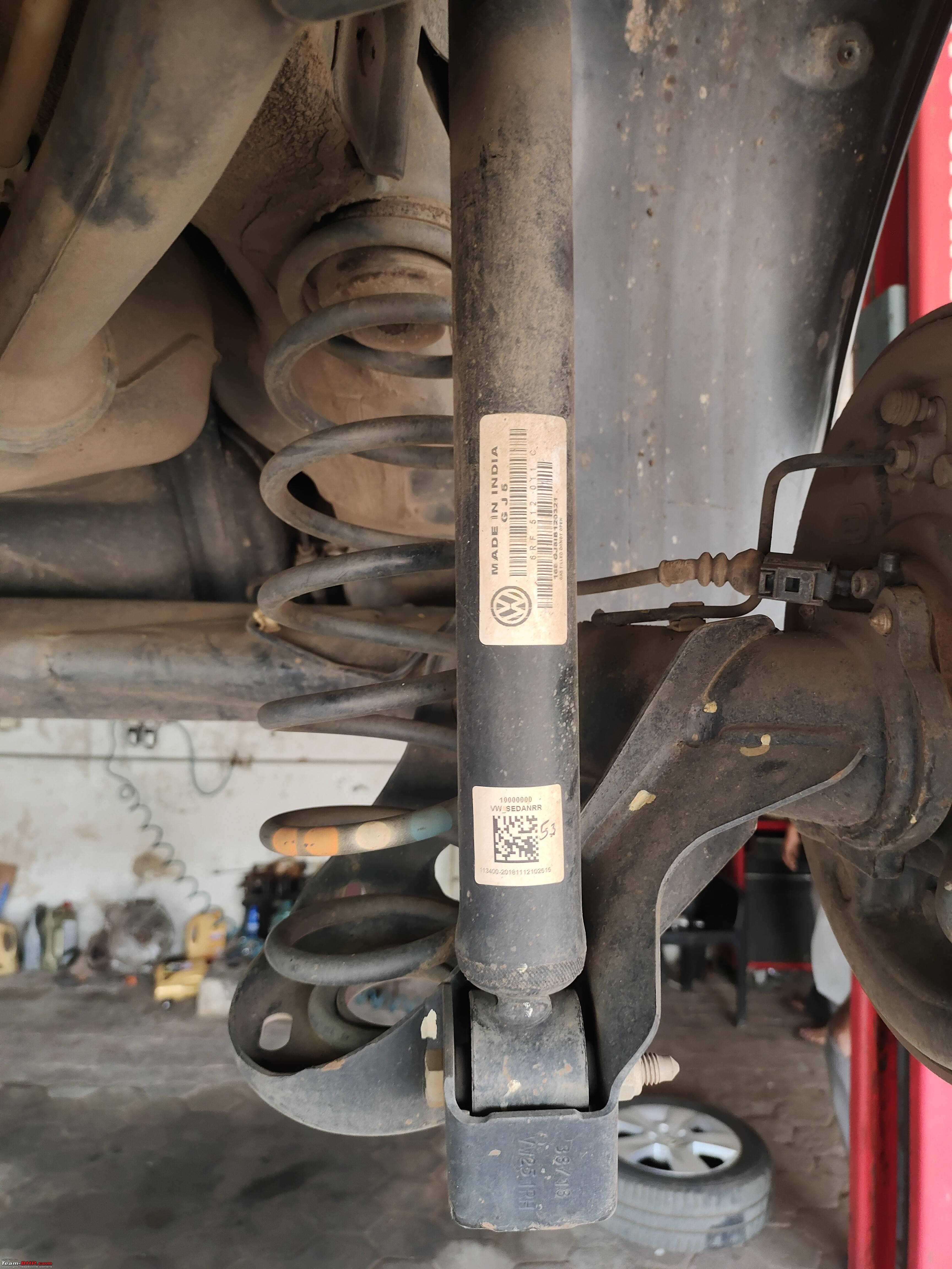

Review: Sachs Shock Absorbers for my Skoda Rapid DSG-3-old-shocker.jpg
Old OE shocker

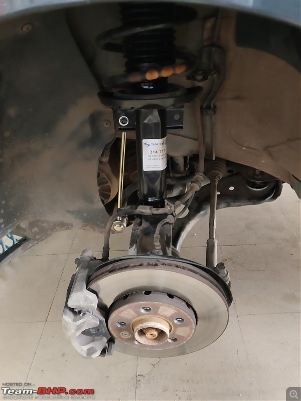

Review: Sachs Shock Absorbers for my Skoda Rapid DSG-4-shocker-removal.jpg
Removing the shocker

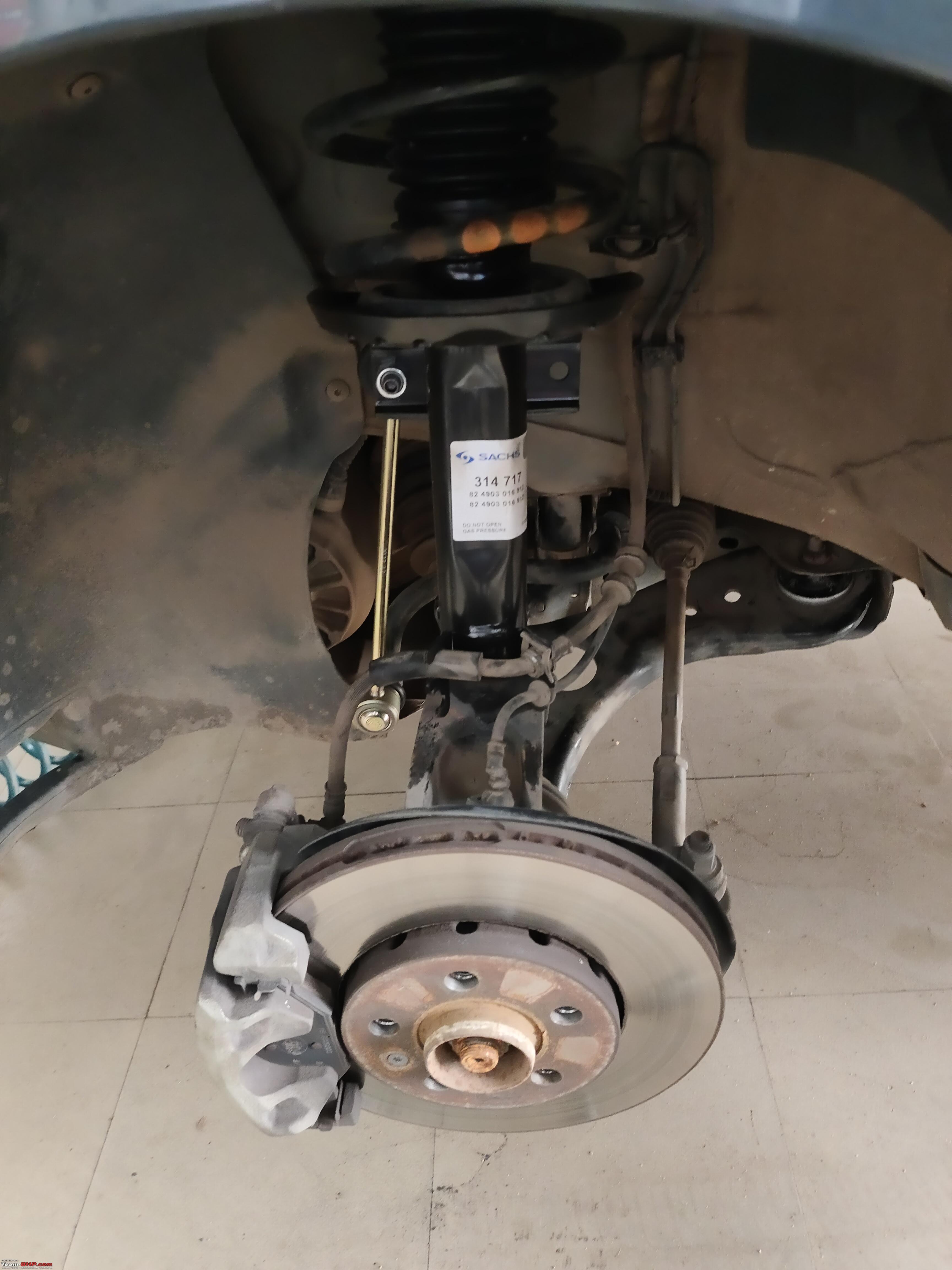

Review: Sachs Shock Absorbers for my Skoda Rapid DSG-5-shocker.jpg

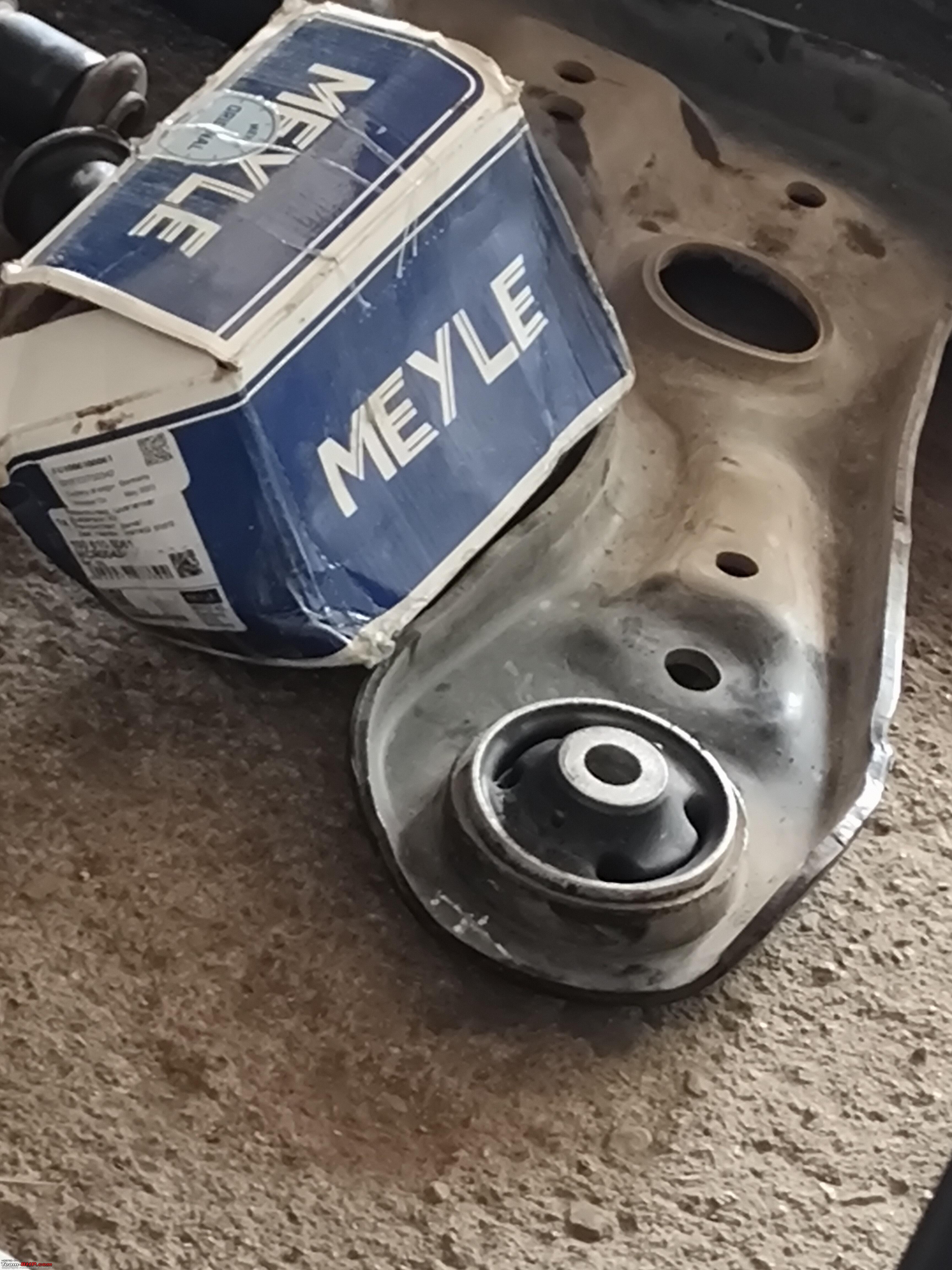

Review: Sachs Shock Absorbers for my Skoda Rapid DSG-7-bushing.jpg
Meyle

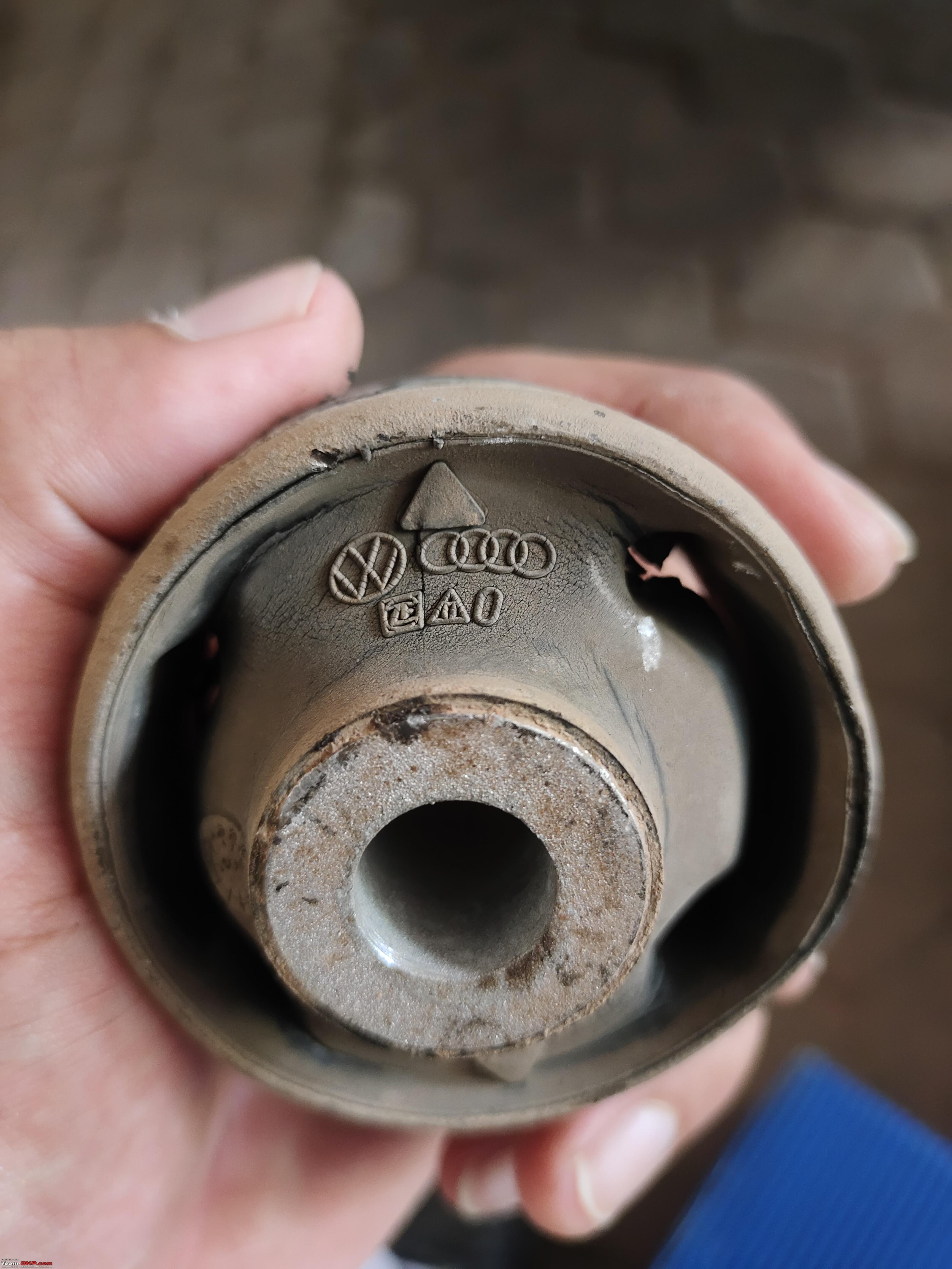

Review: Sachs Shock Absorbers for my Skoda Rapid DSG-8-old-bushing-audi.jpg
Old Bushings had Audi logo

Shocker un-mounting resulted in scratches in the bonnet because of his carelessness. I asked him to be careful but he
Review: Sachs Shock Absorbers for my Skoda Rapid DSG-10-meyle-bushing.jpg

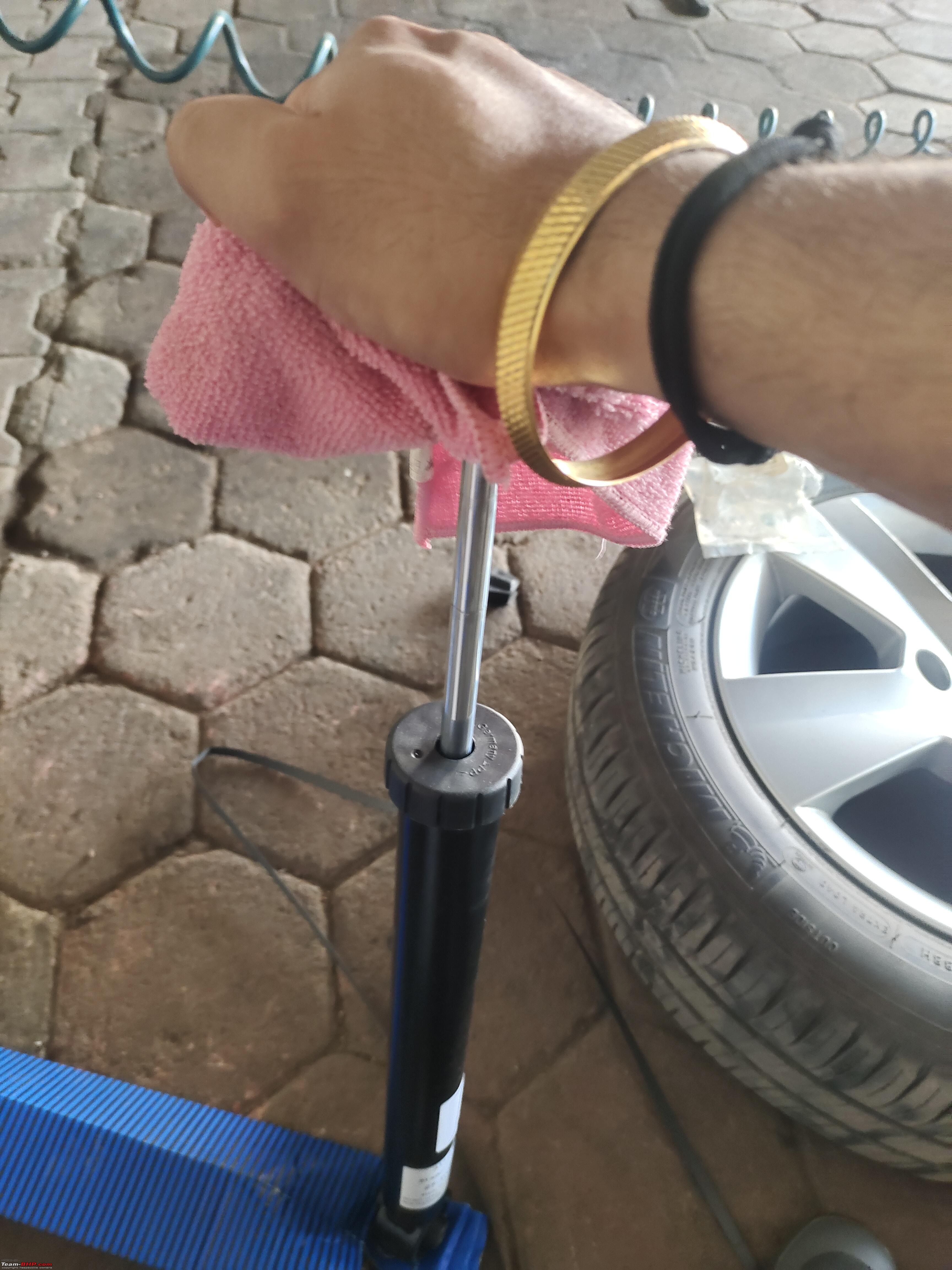

Review: Sachs Shock Absorbers for my Skoda Rapid DSG-16-preparing-shocker.jpg
The seller advised me to manually push the shockers before fitting for 20-30 times so that gas is equally distributed

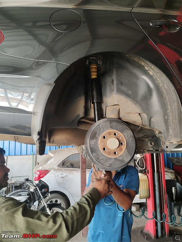

Review: Sachs Shock Absorbers for my Skoda Rapid DSG-19-work-progress.jpg
Glad that Rapid came with underbody protection. It not only saves from underbody damage but also keeps the engine bay clean
