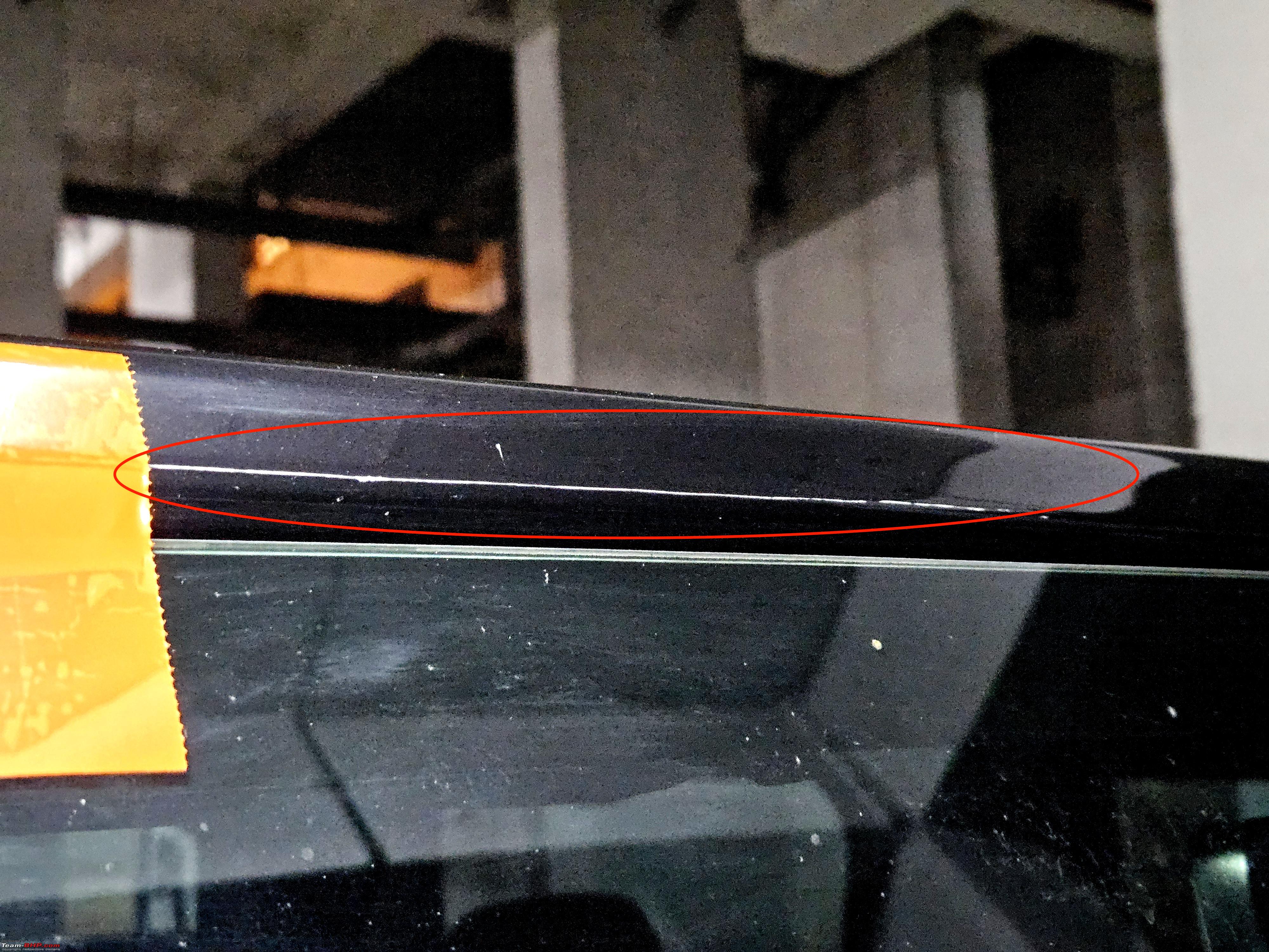

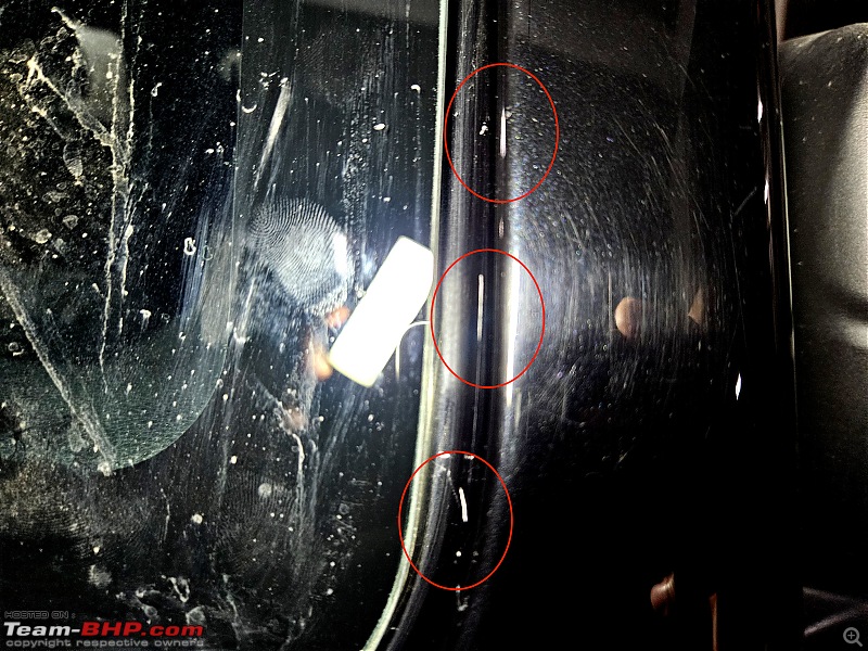

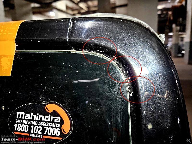

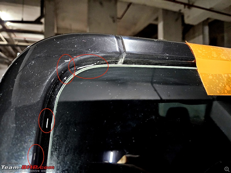

What I discovered after installation of the glass is this:
The scratches are still there and it is the perfect scratch for formation of rust as it is the water channel during monsoon season. When I asked him what he did, he rubbed it off with a black permanent marker. Stopped him there itself.
Now, the problem I face is this:

Please suggest what should I do? If I go to service centre they’d remove the glass again and considering the Butyl used I am pretty sure they would break it. Secondly, the paint too would cost a bomb considering removal and installation of glass plus labour plus paint charges. All this for no fault of mine. I even paid a portion for this glass.

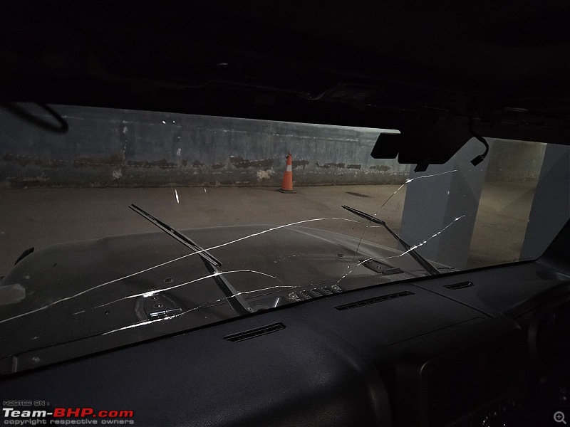

Two weeks later, a pebble hit windshield while I was cruising at 80 which caused a small crack. Thought this was a minor one so won't cause any further damage. Nope it wasn't minor, crack appeared the following day when I parked it for whole day under the sun. Due to certain other commitments could not get it changed.
Few months forward, while returning from Spiti, a small rock hit the windshield again. Thankfully, hadn't replaced it then and the rock did not hit any other painted metal parts.
Horrendous Windshield Experts experience | Damaged entire windshield glass border | EDIT: Resolved-spiti-glass-broken.jpg
This caused lot of cracks eventually. Meanwhile, few pebbles hit windshield too in this period.
Horrendous Windshield Experts experience | Damaged entire windshield glass border | EDIT: Resolved-pebble-1.jpg

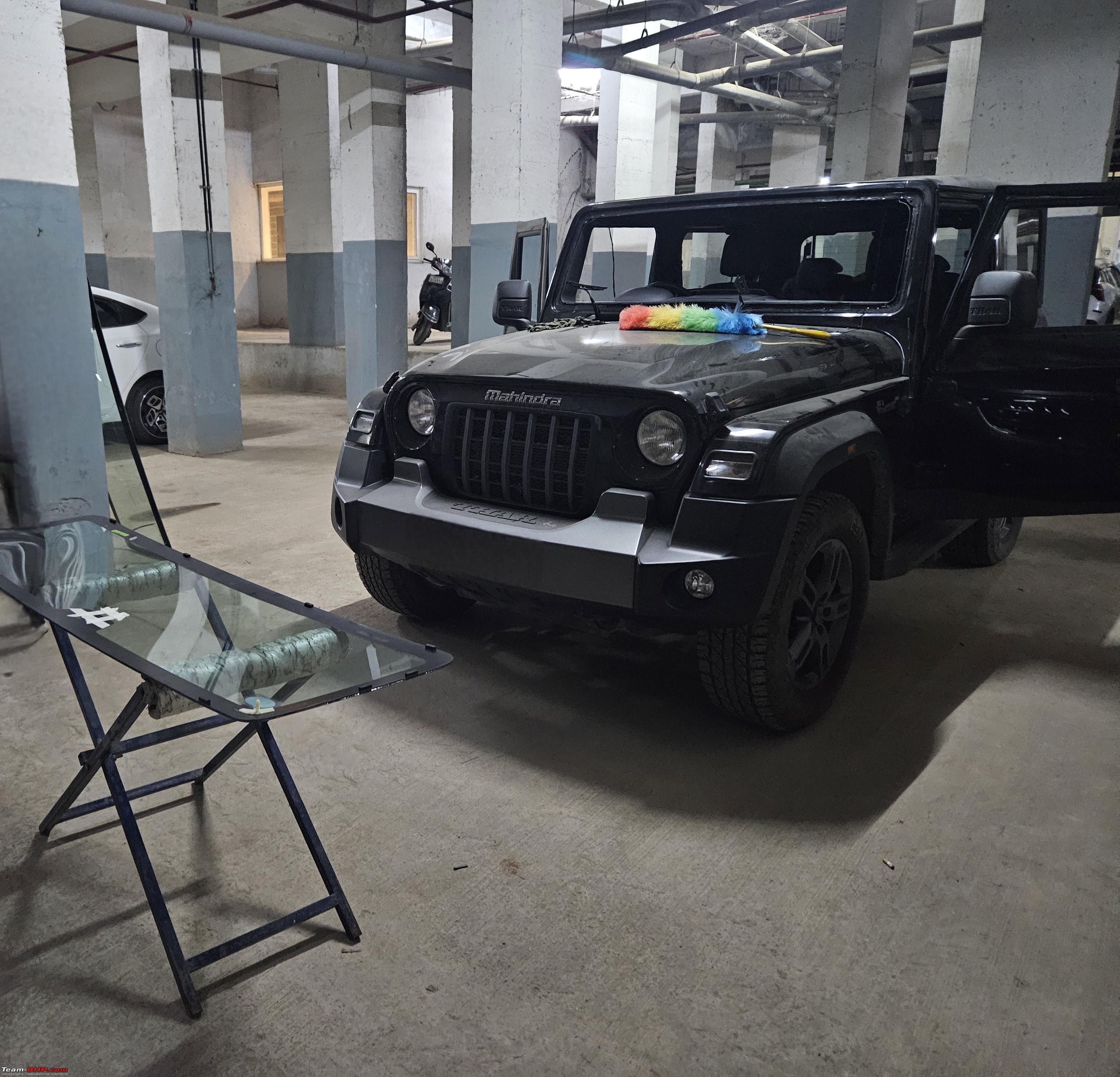

Decided to get it changed few weeks back much before winters set in. This is how it was on the day of replacement.
Horrendous Windshield Experts experience | Damaged entire windshield glass border | EDIT: Resolved-time-changing.jpg
Called up the store and requested them to change this at home, which they obliged.
Horrendous Windshield Experts experience | Damaged entire windshield glass border | EDIT: Resolved-replacement.jpg
