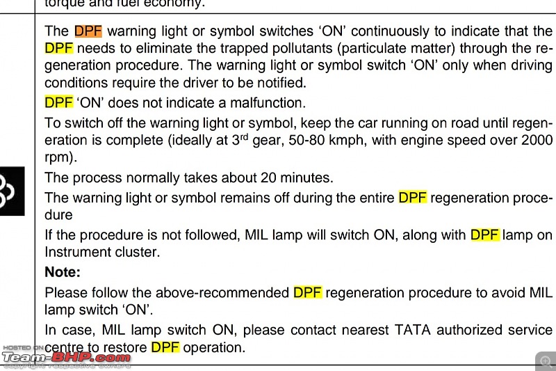

You mentioned earlier that you shift before 2k. The thing with BS6 diesels is that for the DPF to reach the optimum temperature you've to rev it. And since the DPF won't be able to reach the optimum temperature issues like these are common in BS6 diesels. So driving spiritedly once a week will keep your engine happy. I'll attach a reference from Altroz's manual and you can see that in case the DPF light appears you've to drive in 3rd gear at around 50-80kmph(basically over 2000 rpm) for 10-15 minutes. So you can go ahead with the same practice once a week and probably your engine oil level will be the same. Hope this helps
Oil level almost twice the max mark | Now what?-screenshot_2023052011495071_e2d5b3f32b79de1d45acd1fad96fbb0f.jpg
