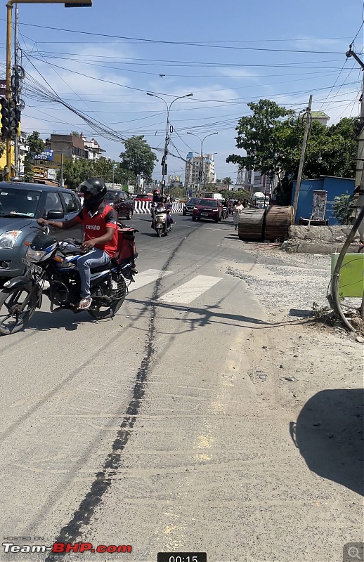

Yesterday (30-4-2023),I was driving in the city when I started hearing a whining noise in all gears above 1st.This has happened once before and it randomly stopped before I could get it checked,but this time the noise kept getting louder.I was asked to pull over by other road users as they kept pointing at my wheels.
Noise:
I got down and was shocked to see transmission fluid gushing out and a long 2km trail of oil behind my car.

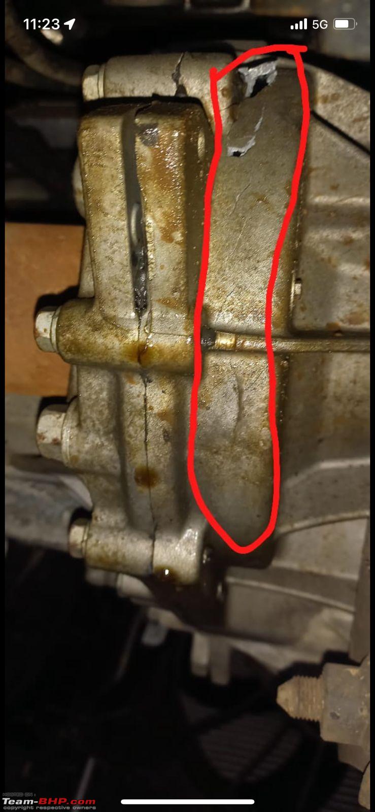

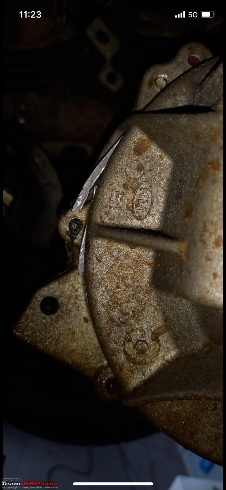

I just received pictures of the gearbox and it is absolutely horrifying to look at.This time it didn't leak from the seal unfortunately.The entire gearbox shell is cracked.And there were no prior signs of oil leakage since the initial fix.

Oh, it's good that they have not blamed external damage, else you would have to go via the insurance route. Can this be due to over-tightening or leaving any nut loose when they did repairs on the gearbox first time?
I see some small particles in the joint (where the bolt is open)

Most likely, Kia will approve a complete change as it will be very hard to put back everything back in a new gearbox casting. And then, if something goes bad again they will have to take off everything apart.
Didn't the dealership just 1 day back said no external damage whatsoever?
Anyways, looks like a manufacturing defect while casting and should be eligible for factory replacement. Good luck and keep this thread updated.

Looks like it destroyed itself from the inside. Shaft and / or bearings came loose or broke off while rotating at speed. Then hit the casing and cracked it. I would recommend seeing for yourself the internals of the transmission and taking pictures so as to have proof incase the dealership / Kia tries to do a U turn and blame external impact later. It would also help the OP to push for an entire gearbox replacement incase they say that only replacement of damaged components is necessary.

Looks mostly like a bearing or synchroniser failure at high speed and that caused it to explode and crack the gearbox housing open. I had suffered this problem in a Scorpio I rented from Zoomcar many years ago. I hope a new gearbox is provided under warranty and not a rebuild of the transmission with a new casing.
