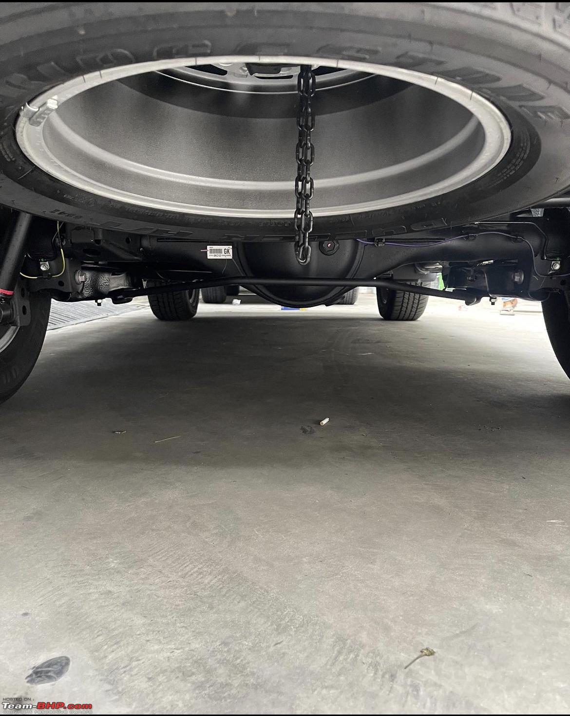

In Indonesia and Thailand, a rear stabiliser bar/ sway bar is a very common aftermarket addition to the Fortuner. You can try that out.
Toyota Fortuner : Reducing body roll-27d070332f91400faed0230517084538.jpeg
https://www.instagram.com/p/CjP4MOoJ...d=YmMyMTA2M2Y=

If it is the 2017 new gen fortuner it already has the rear sway bar. Its placed in front of the axle so not visible from the rear.
Attachment 2397070
Sway bar should connect the suspension arms or the axle with the body/chassis. This bar has two ends connected to both lower arms and no connection to the chassis and so it will not do anything except add weight.
Yeah typical sway bar is attached/linked to part of chassis frame, as well as lower arms.
What then is the 'benefits' if any, of this Fortuner socalled sway bar linking only the 2 lower arms but not the chassis?
