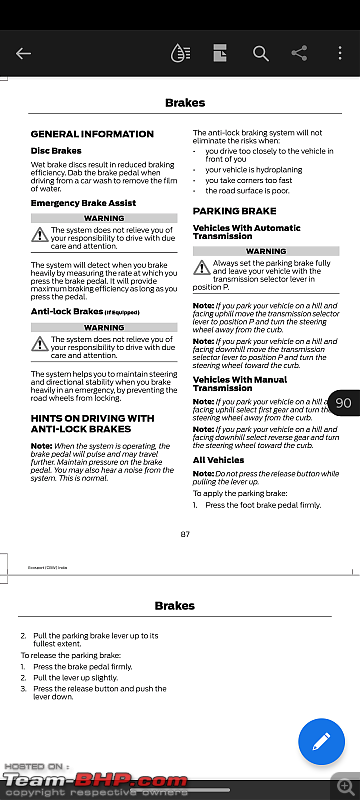

When parking on an incline I don’t trust the hand brake. I have asked many times by my Ecosport’s hand brake does not work for more than 10 degree inclines. Luckily my parking is flat and it does not require hand brake.
But I feel safe only after applying it.
So my vote is paking brake, first or second gear (on an incline)
It’s also important to turn the wheels inside towards the road end when parallel parking on an incline or decline. SFO city mandates this and penalizes who don’t do it.
I had the same problem with my Ecosport and I asked an ex-ford engineer and he said that the parking brake for my vehicle (Ecosport AT) will only work if I press the brakes first, then engage the parking brake and then take my foot off the brakes.
Checked the manual and it says the same thing.
Try, maybe this will help.

I wonder if this is just a way to get away with substandard handbrakes by making it seem like a feature. Imagine your brakes fail and you pull the ‘emergency brake’ just to have to mildly slow down your vehicle.
As per my understanding, they are simply "parking brakes" and not "emergency brakes"
They apparently 'lock' the brakes once applied on a stationary car - or this is apparently the current design. Engineering grads can probably help us understand this better.
Attached a screenshot from the ecosport manual about how to use the parking brakes.
