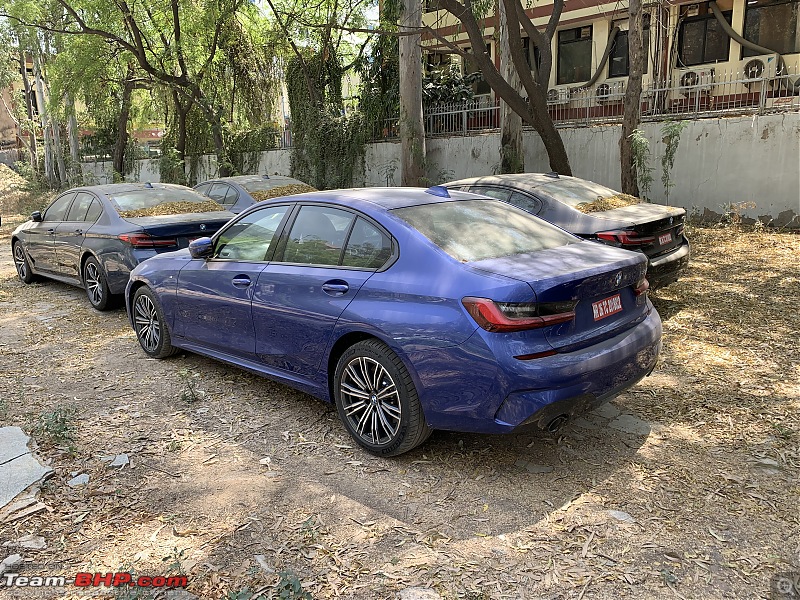

Your BMW Dealer might have parked your car under a tree at a stockyard resulting in this problem.

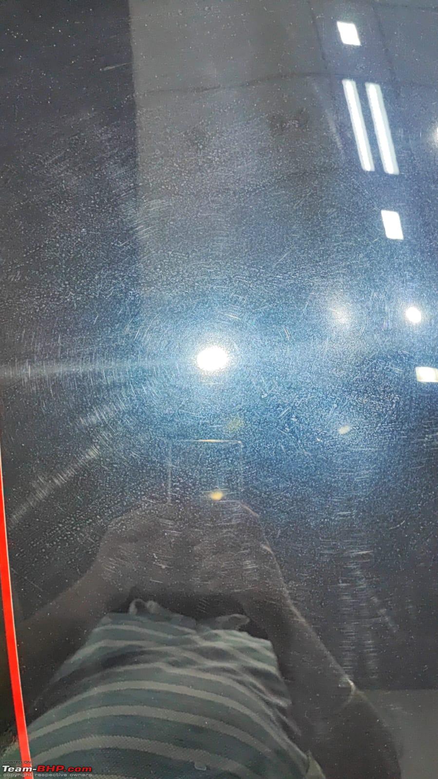

I recently picked a Mini and look at the swirl marks on a brand-new car.

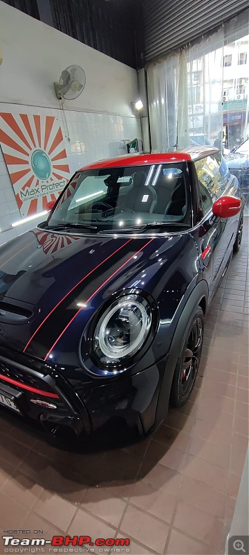

As with my other cars, it was dropped at Delhi to Dazzle guys, and the results were amazing, as always.
Several, stubborn bird droppings on my brand new BMW 3-Series-whatsapp-image-20221210-3.28.37-pm.jpeg
Several, stubborn bird droppings on my brand new BMW 3-Series-whatsapp-image-20221210-3.28.38-pm.jpeg
If you are ok to take the car to Delhi, I can safely recommend them over anyone else.

I purchased a BMW 330i MSport from Bird in Apr this year. The car was first shown to me in the basement stockyard of the showroom. Later when I went back to the showroom to complete some paperwork, the car wasn’t there and I was told it had been shifted to their outdoor stockyard. I made a trip to the stockyard and as feared, my car stood there is the blazing 42 degree summer heat and fully exposed to the elements. The security guard innocently told me there are instances when the car’s bonnet, windshield is damaged by a tree branch falling. These are promptly repaired/replaced and sold as brand new cars untouched since they left the factory. It is common sense to spend an insignificant amount from the earnings to put a sheet roof that will provide atleast some protection from heat, dust, rain and bird droppings. Instead, the top BMW dealer in the region finds it better to pour generous amounts of rubbing compound and polish to remove the damages that could have been avoided in the first place. We are not only paying more of our hard earned money to acquire these cars when compared to our friends outside India but also pay an additional INR 95K as service charges. This, by the way, includes the cost of the cake and the bouquet that is graciously presented to us. It would be better for these dealers to have some pride and ethics and use some of the money being charged to us to deliver a truly clean car! Pics of my car in the stockyard attached.
Several, stubborn bird droppings on my brand new BMW 3-Series-8132a3b512304c3ca4bd8e3b08d2f158.jpeg
Several, stubborn bird droppings on my brand new BMW 3-Series-3a01e4d8cc434605af6bdae891cb5b83.jpeg
