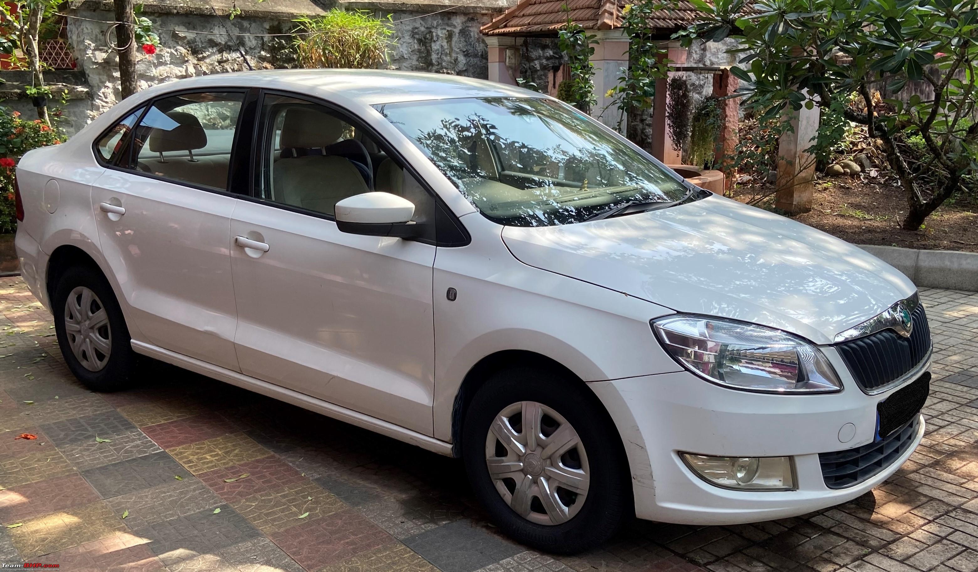

Sharing couple of pics.

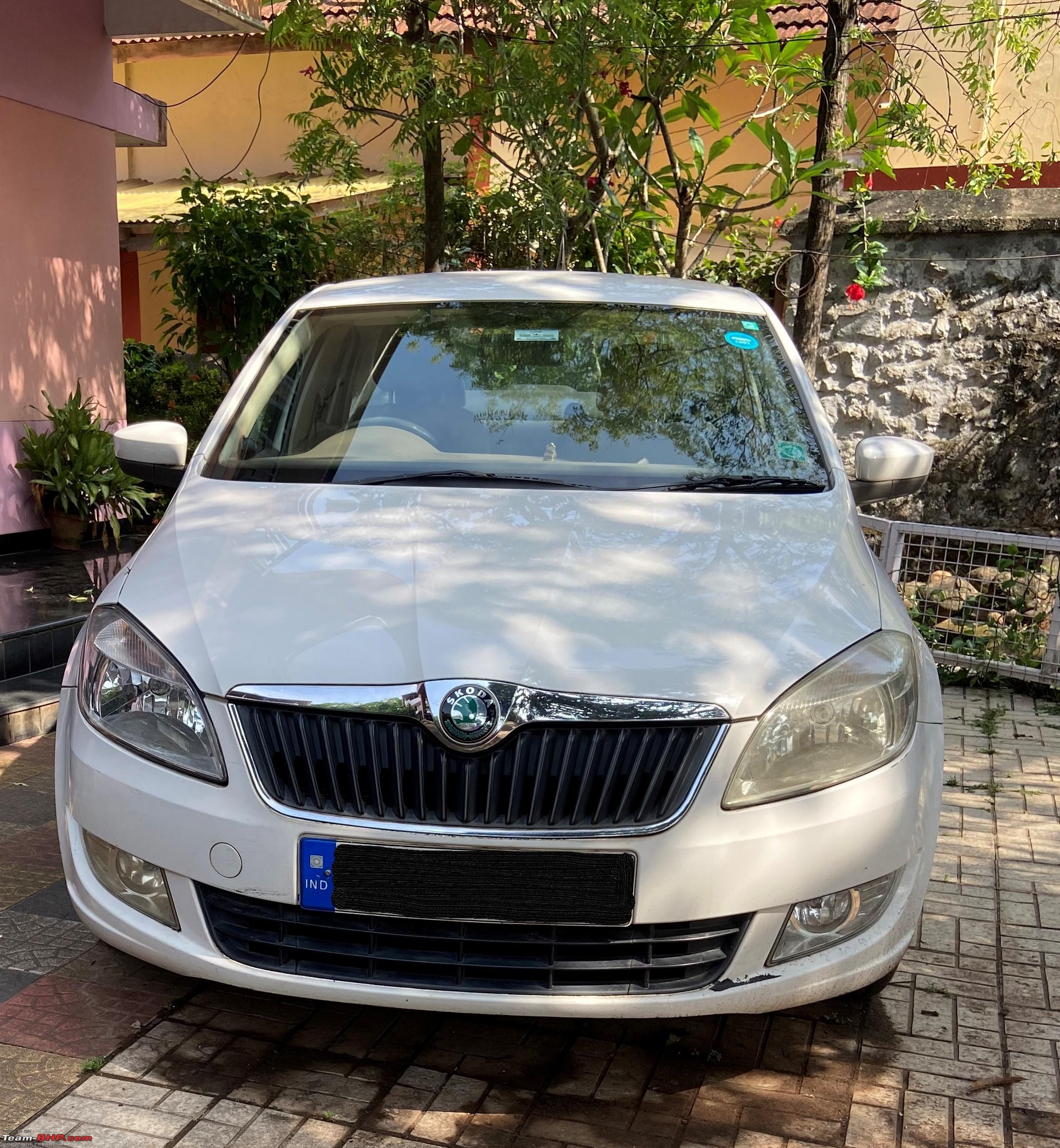

Attaching some more pics taken this month. Even after 10 years the design doesn't look outdated.
