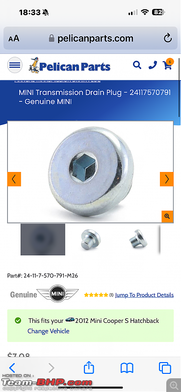

My Mini Cooper S R56 has now clocked ~64500 kms.
I ve done around 31000 of these myself over the last 4 years and Im hoping to do another 2000-3000 kms in the next 3-4 months. My driving is a mix of city and highway and hill driving. And indeed Ive enjoyed the paddle shifters and manual mode and sports mode a lot.
We all know that our Indian Operating Conditions and Start-Stop Traffic and all are very hard on our cars. The Cooper S R56 uses an Aisin Warner 6 Speed TC AT Gearbox and this definitely needs to be cared for periodically.
Therefore, in the first half of 2024 I intend to perform the ATF change again - this will be the second time Im doing it, after the vehicle has come into my hands. To this end, I plan to order some of the essential Child Parts such as Transmission Filter and Gasket and all from the US. And I note that the essential Red JWS3309 ATF Fluid is available on Amazon India thank heavens. It is an import from Germany - Mannol brand. And is available at Rs 899 for a litre. Contrasting with BMW India charging around Rs 3714/- per litre which is what I paid in 2020!
I was in Europe on two separate visits recently. On my second visit last week I was staying in a Conference Hotel right next door to an Exotic Car Garage/ dealer group’s premises which included BMW and Mini Showrooms and Servicing too. So I wandered in and asked them about spares. They politely gave me all the info I wanted.
They indeed sell child parts for the Mini - ATF Transmission Filters and Gaskets and magnets and all that as a kit. They even had stock of the part number I wanted. Genuine BMW/ MINI and that lovely JWS3309 Juice too. However, this being EU, the price for the Filter and Gasket set was around 190EUR. As compared with 25-35 USD in America for equivalent Bosch or Febi Bilstein OES Parts. So they said I should buy from the US.
By contrast, BMW India still insist that these are ‘Lifetime Fluids’ and their concept of ‘lifetime’ has been articulated to me verbally in 2020, as being 4 years! When I told the EU chaps this, they actually commisserated with me about the India BMW’s oddball attitude.
Upon reading up on the internet it is a known fact that changing the ATF is a good idea, perhaps once every 50K miles. Saying this, I personally feel that considering the Indian Operating conditions, it is better to do this at more frequent intervals. Say once every 5 years / 36000-40000kms of running. That is why my decision towards the first half of 2024.
The Mini Cooper S R56 takes in about 6.5 litres of ATF. It is better to buy 7 litres. And when one drains and extracts the fluid, not all of it comes out (only about 4-4.5 litres comes out) because there is quite a lot sitting inside the AT Transmission Housing itself, maybe 2 or 2.5 litres. This necessitates that one has to do the ATF Flush two times. Do it for the first time. This will flush and change about 4.5 litres. Run the car for some 3000-4000 kms. Go back and drain around 2 litres and refill from your leftover stock. It is a fiddly job. But with patience it can be accomplished. Im sure my little Mini will heave a sigh of relief and even bless me afterwards.
So here are the parts I will buy and do this job by and by. I will as usual report back with pics once done.
