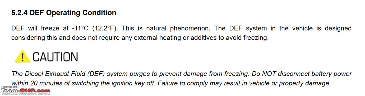

Originally Posted by ninjanayak View Post
I believe there are heating elements in the DEF tank to prevent things like this. correct me if I am wrong.
I own a 2020 Thar and the manual mentions the following:
All your questions about DPF & BS6 Diesel answered by a Diesel Calibration Engineer-def-sub-zero.png
So, that clearly means at such temperatures, the car will be driven without using DEF fluid. That is partially okay as the Odo would display a 800 km warning after which Engine start will not be allowed. Again, that figure is very uncertain and drops rapidly while driving on mountain roads.
It is also mentioned that the "DEF system purges" to prevent damage from freezing. If the DEF fluid is drained / purged out, the return home journey would surely need a refill of DEF.
What are the solutions regarding this DEF? Is there any antifreeze solution that can be used?
I am not sure about this but I guess by purging it would circulate the DEF around the system around the exhaust injector without injecting it into the exhaust so that the heat from the parts around the exhaust will also raise the temperature of the DEF. DEF is a substance that is unacceptable to be dispensed out into the nature apart from being used in the exhaust. Hence there is no way the vehicle will actually throw out the DEF.
AFAIK, most vehicles have heaters in the DEF tank as an alternative mechanism to prevent it from freezing. I remember seeing this in my Crysta as well.
Attachment 2251915
Again, DEF is related to the SCR system which is completely different from the DPF, so I will not comment on it since I dont know a lot about it.
