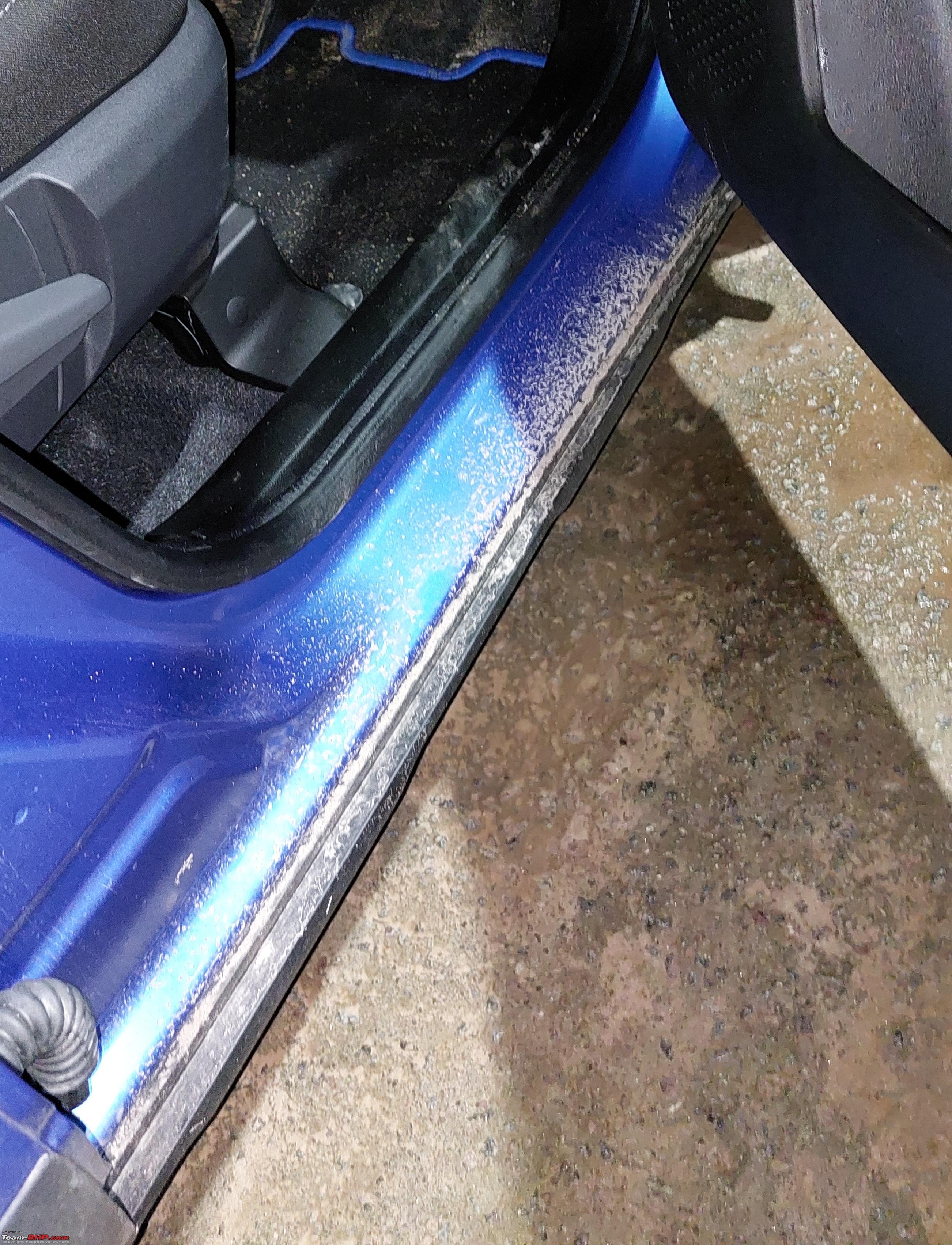

The company is in denial mode, while the service center is doing some Jugad to ease out the situation. On the other hand, the service center told me vehicles plying on the road would get dust and that's normal. So what you see on the door panel is fine and it doesn't impact the horsepower or torque of the vehicle. They really don't have the necessary IQ to distinguish between dust and mud.
The company silence and ignorance of "Indian" customers will hit them back. I think they haven't learned the lesson from Renault Captur episode.
For visibility can I please request a separate thread on this issue?

This problem is across all variants, just have a word with your service center and check. As you said it is a concern if the company doesn't care and is only interested in sales. The ignorance is such that they claim it is dust and it is normal. They just need a reference in a dictionary to understand the difference between mud and dust. I have tried all channels including leadership teams in India and France. Their nonresponsiveness gives out this intuition that they really don’t care as the vehicle is a hit and French is superior so take what is given and keep the mouth shut.
