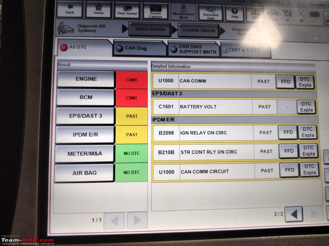

I need guidance related to my Micra Nissan Diesel XV 2011 model, 1,45,000 Km run. The car is being used by my father who drives it locally and is chauffeured around on long trips.
There is check engine light which comes up once in a while followed by oil indicator light and the engine shuts down. Wait for 4-5 mins the lights disappear and the car can be re-started and then keeps running. This usually happens on long trips, anywhere between 2-4 times in a 700km trip. I got the issue checked at FNG who was unable to find a solution and suggested diagnosis at a ASC. The ASC's OBD tracked down the following issues
Check engine light comes up, then oil indicator light, Engine shuts down. EDIT: Issue resolved-d0aa0c25b7dd486fa16ba4ed8b602b45.jpg
Check engine light comes up, then oil indicator light, Engine shuts down. EDIT: Issue resolved-e1ab28724c4646b6a5ae1d6a81fe9ead.jpg
Check engine light comes up, then oil indicator light, Engine shuts down. EDIT: Issue resolved-d16bf59cc5f04f949cbc545ff044b805.jpg

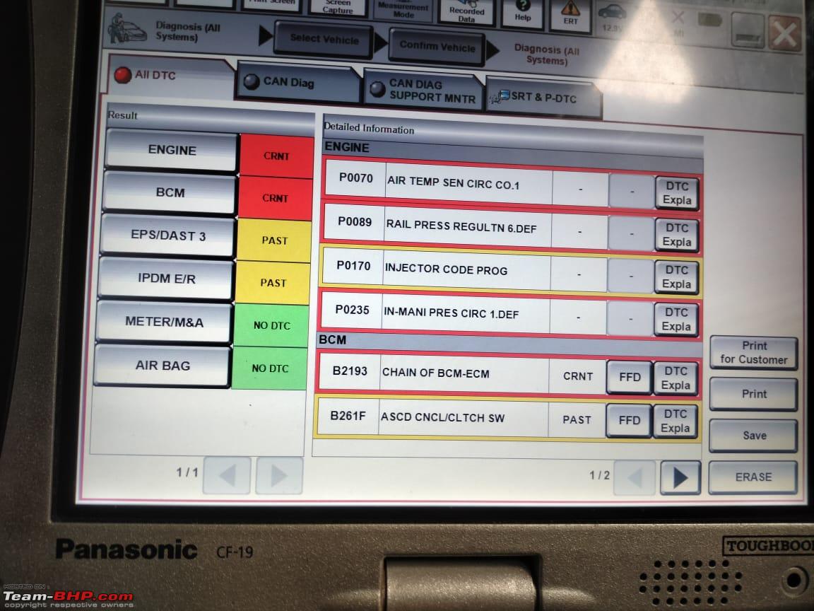

The ASC suggested changing among other parts, ECU & BCU, at an estimated cost of 1,20,000 INR.
Now, this is the real issue; the cost of replacement is more than the resale value of the vehicle.
My query is
1. Can these electronic parts (ECU BCU etc) be repair? If yes, where in NCR? How reliable is the work done?
2. Is it advisable to get them swapped with ECU & BCU from scrapped cars? If yes, where? I was suggested to check in Mayapuri, New Delhi for old ECU/BCU.
3. Can I continue running the vehicle with these issues? Can this be a recipe for a major disaster in near future?

Oil indicator turns up if oil level is high or low. Engine light come ON due to multiple reasons. So, I think, either engine sensor or oil level sensor would be the first thing to be checked. If both of them are working fine, their cables need to be checked for rodents attack. If cables are also fine, then, you can go for further major surgery.
Most of the times, these cables and sensors would be the culprits.
Did you leave the car for service recently? If yes, check if right engine oil was filled and to right level

That is a lot of faults. Often when you have many fauly codes, they are interconnected. I fixed a car once. There were 8 fault codes all connected to the fuel delivery system.
The owner replaced the MAF and the car still did not start.
I replaced the fuel pump relay and deleted the error codes. The car started and has been running since.
I would try to get a second opinion from an independant workshop before you replace the ECU and BCU. I doubt that both can break down at the same time. It is like puncturing all 4 wheels at the same time.

That's a lot of errors. The first though is to check for faulty sensors. My advice would be to find another FNG to diagnose the issue, and if at all they can't and you want to go with the ASC's diagnosis - you can take that report to an FNG and have those major parts replaced for a much lower amount. ASC's will charge heavy premiums on these parts.

ECMs & BCMs are repairable to a large extent, and there are many folks in the NCR who do it. There's the one GTO pointed out, though I haven't been to him for some years...

Considering the mileage and that it's a DCi engine, you are probably having worn out injectors.
Please look for smoke from the exhaust as the vehicle is started in the morning (cold start).

Here is an update on my Micra
I have been informed by a Garage in Noida, where I sent my car for diagnosis, that the issue is due to bad fuel. There is damage to fuel pump and 2 of the injectors. ECM BCM are all fine. The pump has been repaired and injectors need repair/ replacement from scraped parts. Also the fuel tank needs cleaning and fuel filter needs replacement.
Awaiting a report on status of injectors

Firstly take a second opinion from another ASC or a third party multi car workshop. On most occasions it can be just a sensor malfunction, which results in multiple errors. Secondly your ECU may need reprogramming and updating.
Its a general trend, to look at the mileage of the vehicle and then just quote basis replacement of major parts as the general notion of the service center and the customer is that the car is run 1 lakh + kilometres, so there can be a major part replacement. Just take a second opinion before you take the call.

If you are keeping the vehicle for long, replace all 4 injectors to avoid the rework later. They may fail as well, its just a matter of time. Our experience with servicing the injectors is not good, the NVH got worse, it is smoky and contaminates the oil fast.

Injectors can be refurbished easily. New injectors are definitely expensive. See if you can get injectors from a scrapped car. Either way new/refurbished injectors needs to be registered with the ECU by updating the serial number on the injector. This is done by a scan tool.
If you are refurbishing the injectors, suggest you get all 4 done. Chances are the remaining two may also be at the end of the life
