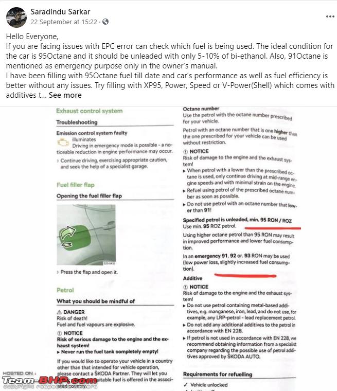

Happened to see this on facebook. As per the manual normal petrol is to be used only during emergencies.
Name:  kusha user manual.PNG
Owners can confirm if this is indeed the case.
Premium petrol is rare outside of major cities limiting the utility of this vehicle.
Attachment 2213867
I think this should be added as a major highlight of our official tbhp review, that only if you can ensure 95 octane petrol 100% of times, then only you should buy this car. Otherwise be prepared for regular fuel pump breakdown till you get frustrated and sell the car.
It's unethical to sell a car that is only designed to run on a fuel that is not available at even 1% of pumps across the country. FYI, Speed and power are regular 91 octane fuels with additives, which again are not skoda approved additives if you are a person who goes by the book and strictly follow the manual. I have seen speed95 at just a handful of pumps in my city and Its illogical to go 10 kms and waste an hour for refueling a car . Even electric fast chargers are more common here than 95 octane pumps.
The car should have come with a disclaimer and appropriate "BEWARE OF DOG" like warnings if it cannot handle regular adulterated fuel sold in our poor country which every other car from humble marutis to Aston Martins and Ferraris gobble without a burp. It's a very very Immature and shortsighted suggestion to fill 95 octane fuel to avoid this issue.
Rahul9229 is offline   (26) Thanks

1. Happened to see this on facebook. As per the manual normal petrol is to be used only during emergencies.
2. Premium petrol is rare outside of major cities limiting the utility of this vehicle.
1. Quite weird, hope the owners were explicitly informed about this and not assumed.
But still it mentions the side effects of 91 fuel as low power and high fuel consumption.
Nothing about an EPC error stalling the car or the check engine light coming on and the car refusing to start.
2. Skoda already know this, not the issue, IMHO.
