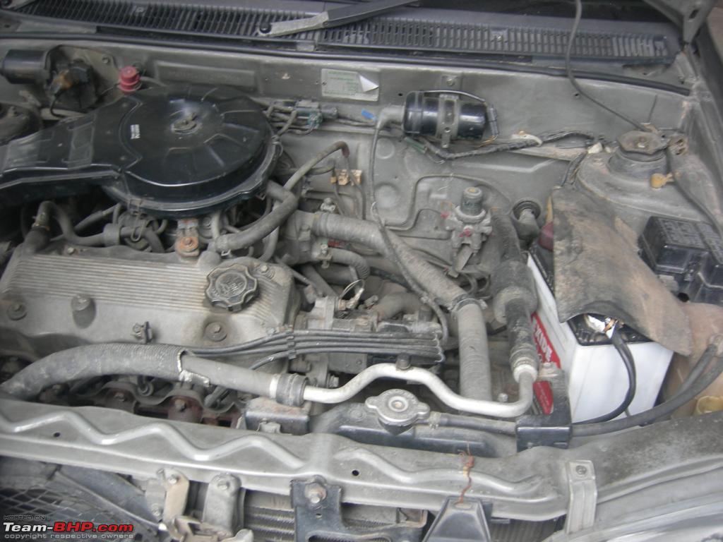

One last wish | Restoring my father's 1995 Maruti Esteem-img_20210125_125030.jpg
This petrol engine is smooth and silent.Other than a standard oil and filter replacement the mechnical section needed an overhaul.We had to replace
1)Front lower arms(LH and RH)
2)Steering box
3)Clutch Assembly
4)All 4 Shock Absorbers (Complete Assembly)
5)Alternator Bearing
6)Engine Belt
All cables were also replaced

2. The engine bay looks so stock even after 26 years
