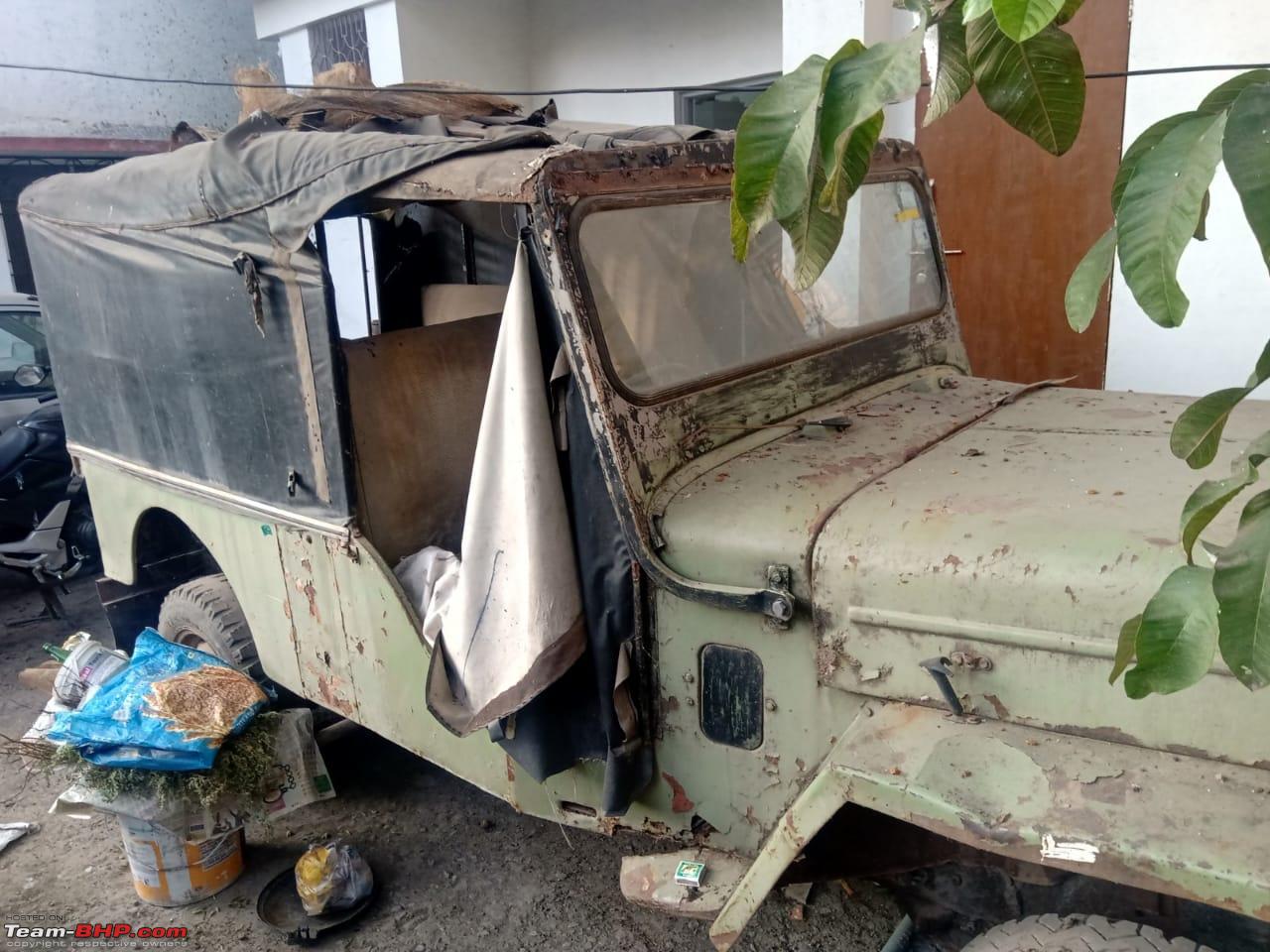

My uncle used to own the 1983 Mahindra CJ 500 D since the past 33 years. It was purchased 3rd hand. It had been occasionally used and was last driven in 2014 and wasn't very well maintained until I finally decided a few months back to start restoring it. It was in a pretty bad state, had been lying around all these years in the open through the hot summers and pouring monsoons as well. Battery had been stolen, other exposed parts had been covered with debris and dust if not rust.

Specs:
4 cylinder 1826cc naturally aspirated International Engine.
(Still can't figure out the Engine Model)
3 speed gear box (RWD)
Wheelbase: 101"
Tyres: 6" x R16
Brakes: Hydraulic drum brakes.
Suspension: Front & Rear Leaf Springs
Inspired by popular automobile restoration television shows like counts kustoms, counting cars, Leepu and Pitbull, etc. I had planned to restore and customize the entire jeep myself initially. Moreover having worked with my college club Team Predators Racing, my enthusiasm was doubled.
Finding spare parts was a challenge in itself and the closing down of shops, unavailability of parts, etc due to the ongoing pandemic had lessened the chances of quicker procurement. Luckily I found a jeep mechanic close to M.S.E.B. Power House Circle, Rastapeth, Pune who guided me to where I can purchase spares from. Suleman Arab a.k.a. 'Arab chacha' was impressed to know that I'd been working on my jeep myself and gave me a short history lesson dating back to the WW2 explaining how the first american jeeps by Willys Overland Motors had entered the Indian markets post war.

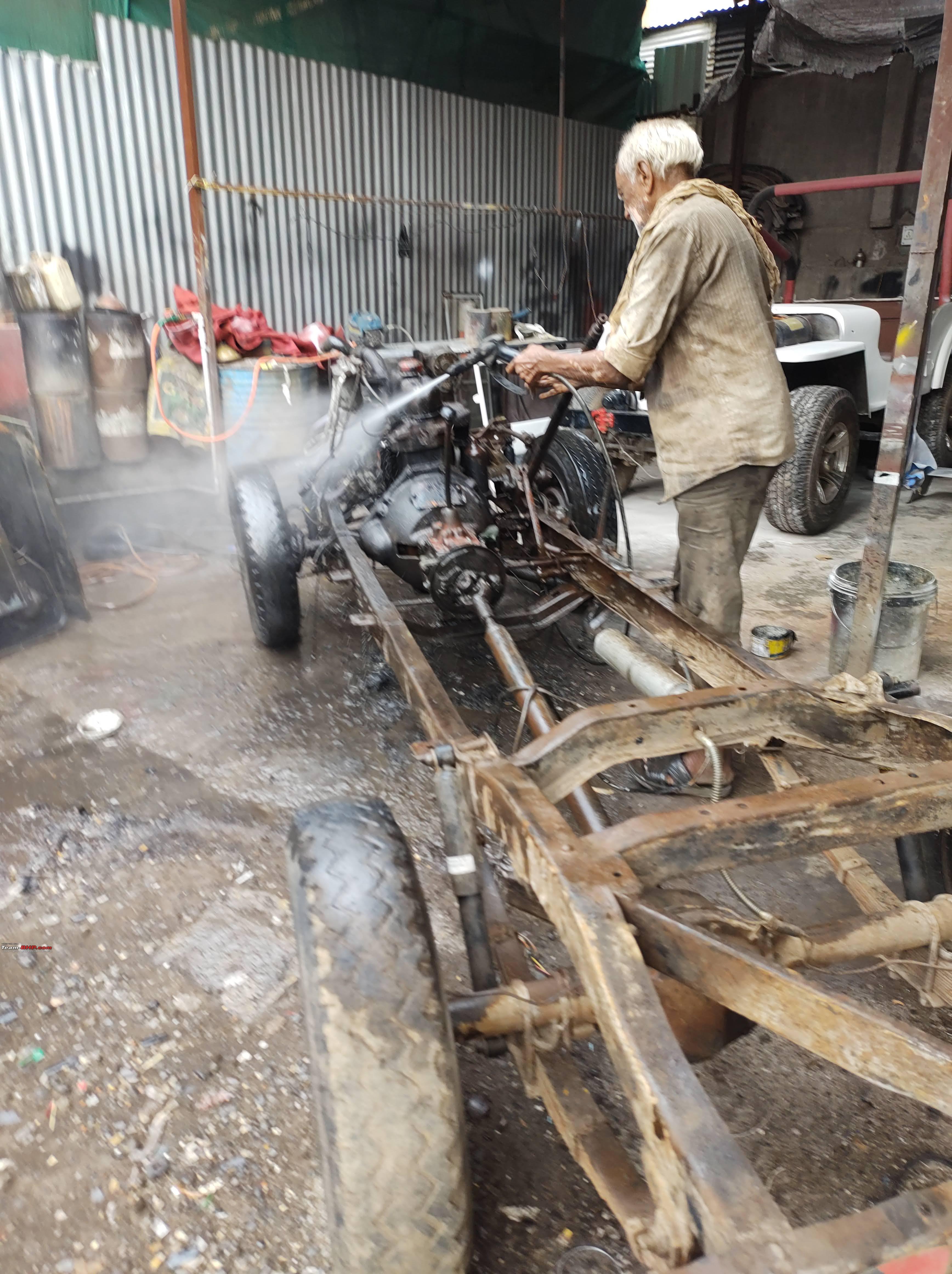

New Shocks and Fuel Tank
At first I got the tyres checked for punctures, despite of all the years of lying around the tyres didn't have a single puncture. Of course the tyre tread was worn out a little. Since the wheels were out, I fixed the newly purchased shock absorbers.
Then I replaced the leaky fuel tank and all the fuel lines as well. It has a oil bath air filter. After cleaning the air filter and the fuel filter, I dismantled the cooling system and removed all the debris and rust, fixed it back and poured in a mix of water and coolant. The engine was running after a few attempts of cranking and the engine sound refreshed all my childhood memories.
Simultaneously I had been working on the gearbox. The gear lever was stuck in first gear and just wouldn't move, my uncle always left the gear engaged while parked. I recently discovered that the handbrake mechanism was a transmission brake placed just behind the gearbox, but didn't see any lever to engage it from the cab.

Work done as of now:
1.Gearbox overhauled
2. Brake shoes replaced.
3. Clutch Plate replaced
4. Wheel Bearings greased
5. Steering system serviced (play minimized)

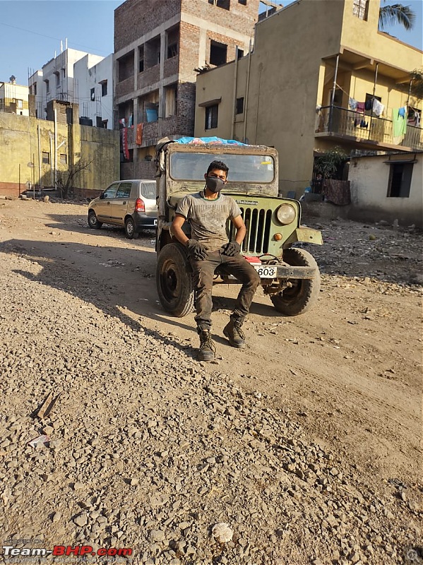

My 1983 Mahindra CJ 500D Restoration Project-img_20210414_163429741.jpgMy 1983 Mahindra CJ 500D Restoration Project-img_20210416_165327349.jpg
