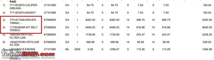

Prelude: I have a preowned duster RXZ AMT 2016 model which was bought in June 2020 and at the time of buying it had clocked 69000 kms on the ODO. All the services were carried out by the A.S.S itself I got the annual service done at the A.S.S at 74000 kms and the current ODO reading is 76390.
I recently got the anytime warranty for 1 year for which I paid 29165, I could not get the normal anytime warranty (costs about 19000) since the previous owner had missed two service intervals and got it serviced a little late hence, I had to go for Improper Service Anytime Warranty by paying 10k extra.
Recently while driving I noticed some engine noise, took it to the FNG mechanic and had a test drive with him and made him hear the sound but he could not pinpoint the issue and he was the car to be left at the service center to take a look. Since I had an active warranty, I denied and took it to the A.S.S on 30th March. They checked and said that due to engine heat the crank shaft oil seal bulged causing engine some oil to fall on the timing pulley and thereby changing the engine timing itself.
Since I had warranty, I asked them if that can be repaired under warranty but they denied. The reason given – the previous owner had not agreed for the entire coolant to be flushed and fresh coolant to be added at 60000 kms as per the maintenance schedule and that the engine got heated due to this (car had max level coolant which was topped up) and bulged the crank shaft seal making the oil to fall on the pulley. Since this issue is related to coolant they denied to repair under warranty.

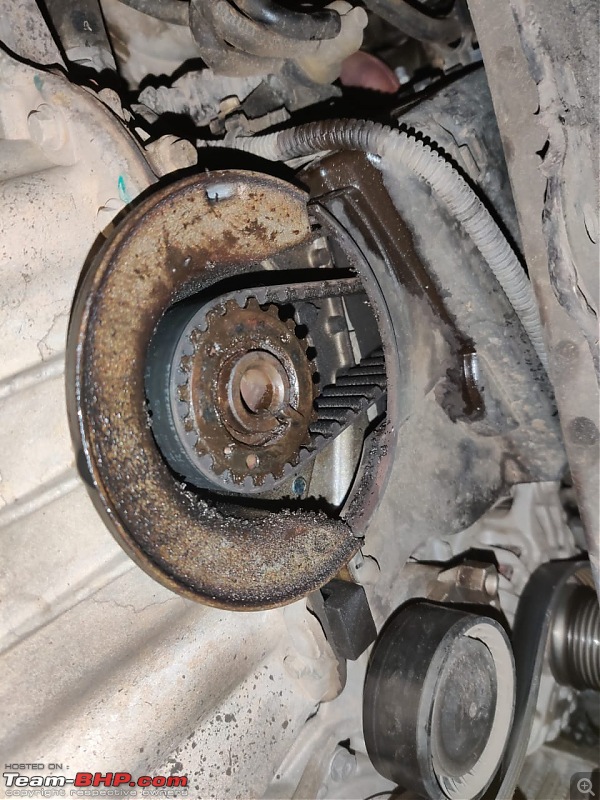

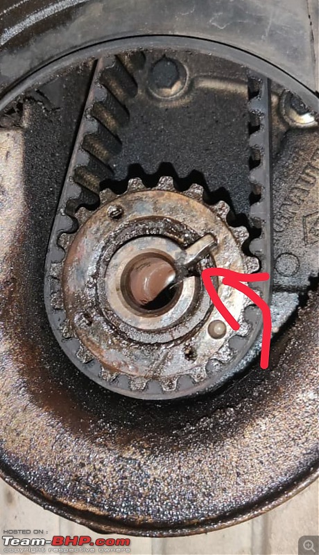

The SA sent me the below images:
A gap can be observed as marked in the third image on the crank shaft which was never communicated to me.
I told them that I will take a look at the car and decide what to do next. Visited the A.S.S on 2nd April and to my surprise I see that everything was closed and car was out of the ramp. I asked them why they have closed it up when I clearly told them that I need to take a look but they said they cannot keep it like that. I got suspicious of their behavior so got the car back.
After that I dropped an email to the S.A and the service manager to give me in writing or in an email on what diagnosis was carried out and how was it concluded that it had happened due to coolant not being replaced at 60000 kms to which till date they have not given a reply and have been beating around the bush and asking me to visit the A.S.S.
I dropped an email to few having top posts at Renault but even after two days there is no call or even an email from anybody asking what is going on. Have raised two complaints from their website (case numbers) but nobody got back and if I call their toll free number, the customer representative says they are looking into it and somebody will get back.
I really do not think the oil seal bulged due to coolant and also thought the timing should not jump just because some amount of oil falls on the timing belt ( engine oil level is at max ) and that just to deny warranty they are linking it to coolant.
] when I spoke to the SA, he said if the coolant had been flushed and fresh coolant added, it would have retained its viscosity and ensured the engine temperature remained under control but since the coolant was topped up, it has lost its viscosity and could not keep the engine temperature under control which caused the crank shaft seal to bulge.
Sorry to hear about all of this. It is a bit messy I am afraid. I think you have asked some good questions,
Couple of thoughts/comments. Viscosity is completely irrelevant when it comes to old and new coolant. Maybe something gets lost in translation here?
The main reason for changing out coolant and a flush is to ensure any rust and debris in the coolant system comes out. Also, the coolant will, over time, loose it’s ability to prevent corrosion. So, yes a coolant system needs to be flushed and re-filled with fresh coolant in accordance with the manufacturing recommended maintenance practice.
Yours went well over 10.000 km over the recommended interval. I would think it unlikely for anything as dramatic as overheating to place, but that will be difficult to prove. That’s unfortunate, but it will be difficult to argue.
The rust and other debris can settle in places within the engine and or radiator. Which means in certain spots the cooling will not be optimal. Your Engine Coolant warning light measures the temperature of the coolant circulating through the engine. But that is sort of average temperature. If say, one cylinder is partly blocked to scaling, that will simply not affect the temperature of the coolant.
Again, I think it is unlikely to be the case, given it is still a relative low mileage engine. But you can see why your S.A. is adement. He does have a point in terms of the coolant should have been replaced.
However, I am not so sure there is any correlation between the the crank shaft seal failing and the coolant as such. Unless there was a massive cooling problem, this seal won’t fail. There is no cooling around the seal. The seals operates at whatever the engine casing/oil temperature are. In order for it to fail, the temperature of the engine and oil would have to be sky high and you would have been looking at some very serious engine damage. Not just a seal.
Additionally, I don’t understand how the oil leak can cause the timing to be off. It looks like the oil leaked onto the crankshaft sprocket. That is toothed timing belt. It won’t slip it can only jump a tooth. And it will only jump a tooth if the belt was not tensioned properly, or was stretching too much due to wear. Not sure when this belt needs changing?
I am not quite sure what this gap on the photo is supposed to be indicating? I am not familiar with this engine, can the crankshaft sprocket somehow change its orientation? (in which case the timing would be off too).
I don’t understand why they claim the timing is off. Is that gap some indication as to how the sprocket needs to be aligned? Perhaps other members more familiar with this particular engine know?

Sorry I forgot to mention in the first post, the SA took 3-4 days to check history and told me that since coolant was not replaced as per schedule and if any issue comes wrt coolant it will not be approved. At that time itself I had told him that it should not be assumed that I drove with out any coolant and that every issue I report should not be linked to coolant and the same is happening now
What I understand is that if anything would have happened to the engine, they would somehow turn it on to the coolant and not accept the warranty. This is clear foul play.
I am sure experts here will guide you but these are my two questions.
Isn't the extra cost meant to cover the additional risk to them due to the "improper service"?
You are responsible to ensure compliance to the maintenence schedule after extension.
I did ask the same question that they charged extra plus it is clearly saying anytime warranty with improper service but still they go on repeating the same story.
The timing belt was changed at 64000 kms during the routine service.
From what I have understood : The constantly turning pulley has caused a play on the cam shaft, ideally when the pulley is locked on the cam shaft there should not be any gap at all. If there is any gap that can cause a jump in timing since it alters the way the pistons work. I am not sure how this play came, I suspect something was not done properly during the 64k service when timing belt was changed.
There should not be any gap/play on that shaft and I think the bigger teeth like thing is the lock to secure the pulley on the shaft and a bolt will be fixed to keep them together.

From what I can see, the water pump is driven by the timing belt - Why was the timing belt changed ahead of Schedule? Perhaps the water pump failed and overheated the engine. While fixing this they have changed the pump and belt.
The timing belt change process was not done properly and now it looks the way it is. A leaking seal wont send a locking pin out of whack as seen in the picture.
I do not think the repair is costly, forget about the extended warranty for now, fix this and get the car back ASAP.

I had asked few questions to the service advisor which are listed below for which he has not provided any answer, have sent him multiple mails but there is no answer to any of these yet. [/list]
The gap what we see from the photograph is nothing but the design itself of the gear is done with a groove.
If you can visit the dealer once more, this time with a motive not just to check the 60K service job card but also the last service too. The dealer seems to be playing a scapegoat here.
With regards to the point where the dealer speaks about previous ownership it is absolutely irrelevant to the current owner. As a new owner you have got everything checked and replaced with respect to regular service. IMHO, I believe it is A.S.S team who neglected with overconfidence on purpose to thoroughly inspect serviced vehicles prior to delivery.
For Duster, major service is at 60k kms where timing and drive belt needs to be changed so it was as per schedule
Yes even I strongly believe this should not happen.
Two things which SA says do not add up here IMO:
  • Oil seal should not bulge due to coolant
  • Even if oil leaks on the timing belt it should not change the timing as it is secured firmly by the pulley, locking pin and secured by a bolt
The approximate numbers I got is - if it is a repair it will cost about 1.8-2L and if it is major then the engine needs to be replaced which is approximately about 4L.

The problem is the previous owner was getting it serviced at another A.S.S(Whitefield branch) and after buying the car I gave it to another A.S.S (Mysore road branch) since this is near to where I stay. Another reason why they are trying to cook up some story is probably because of this, negligence caused by another center and the other center has to repair under warranty. Will try to contact the SA from the other center where timing was changed and demand the job sheet, will post updates on this .
This is from the invoice copy of the previous service at 64k kms when timing was changed.
I think that gap will hold the pulley but there is some amount of play on the pulley when it is connected to the shaft.
